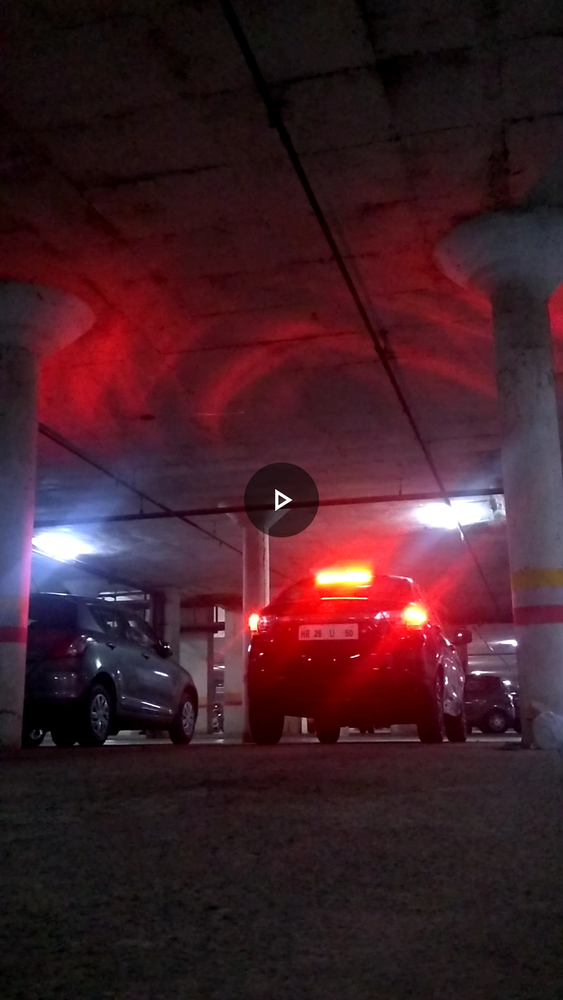

i own Tata Tigor xza 2018 egyptian blue
my issue is with the high mounted led stop lamps above the rear window
the led light does not illuminate completely only the middle portion lights up
i have seen all tigors with full working led stop lights
Please help
here i am attaching 2 pics
the first is my car

Sushant, I have XZ(o) model and in that the rear mounted LED light works fully. It might be a variant specific feature. I think XZ(o) and now XZ+ are two variants in which full LED stop lamp is given by TML.
