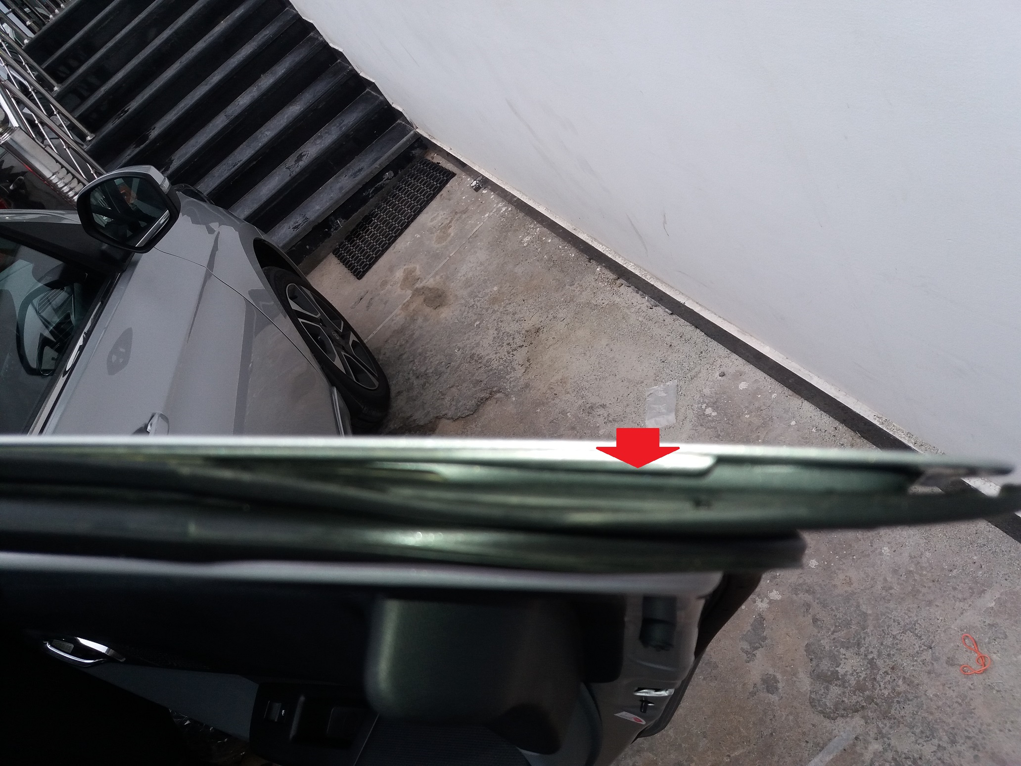

The quality issues / finishing issues which I came across and mentioned here made me to take my 2 day old Tigor to the service center today as I was feeling itchy to get them resolved. Well, it seems, these quality issues are not in capacity of the dealer to be rectified to perfection.
1) The misaligned glove box: I posted earlier about my car's glove box lid to be mis-aligned from left so upon showing it to the dealer, their representative made efforts to align it at best but ended up unsuccessful. Though the gap on the left corner became very less, the right corner got mis-aligned by about 0.5 inch. He tried to punch the same but no success and it still remains as it is i.e mis-aligned. While coming back I tried my hand at it and let me add here, there is design flaw between the lower curve of the dashboard and the glove box lid. If you press from left corner, the right corner comes out and vice versa. I tried to push it and the plastic got jammed and the glove box lid became non-functional. Upon further pushing the lid came out and finally the box was working with right corner gap still there. This problem was present in their display model too. Hence, I feel, there is nothing that can actually be done until TML takes note of it. Have to live with it!
2) Rubber insulation used on the door: My car's all 4 door's rubber insulation from edges had come off and there was gap between the metal and insulation and it was visible too. Same issue with the display model too & even in a Hexa. Although quality of rubber is good but the fitting is not good. I saw a piece of double tape fixed on the edge but that too could not hold the rubber. I called the GM of the dealership and tried to explain it to him. He check out the same and the only possible solution to it was application of a Double Sided Tape on the metal door frame and the rubber had to be pressed against it on all 4 door's edges. I would suggest, keep a roll of 3M double tape handy. There seems no point in cribbing on this issue because the guy there told it is purposely made flexible. I believe those of us who have already bought the car need to wait for a permanent solution on this from TML otherwise 3M double tape is a quick fix. I had a word with the GM on this and he told, even if the insulation is replaced then also this thing won't be resolved as it's a design feature.
3) The Empty Rear Fog Lamp: No resolution to it. I will re-check on this and see if the bulb can be fixed in it or not. Guys there told me it remains empty and no bulb is provided in it.
