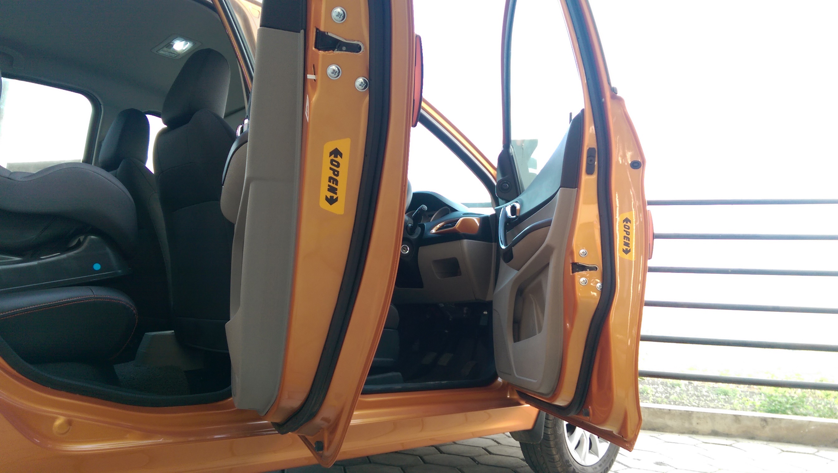

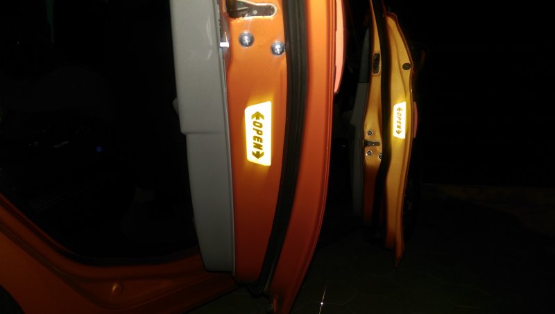

And by the way, I received these door open reflectors from Aliexpress and stuck them last week:

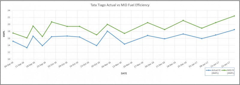

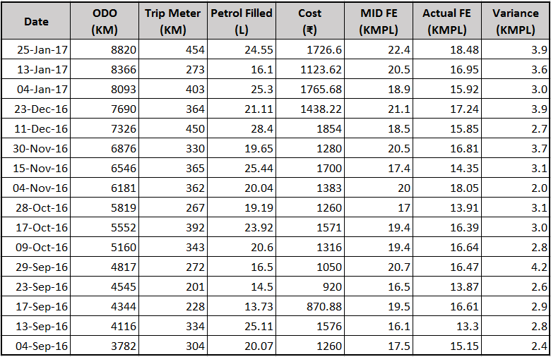

My Tiago's Mileage Chart:
Source Data:
Stats:
  • Lowest Variance: 2.0 kmpl
  • Highest Variance: 4.2 kmpl
  • Average Variance: 3.1 kmpl
Parameters:
  • My drive routes are repetitive and typically on 70% dual carriageways and 30% city roads with intermittent AC usage.
  • The roads I drive don't let me use Eco mode unless I drive at odd hours.
  • Always refueled at the same HP COCO station.
  • All calculations are done by tank full method (using Fuelio app).

Wow!!! Thanks for these data... I have one suggestion. could you also please plot a line each in the graph for Avg. Actual FE and Avg. MID FE?
Or could you please tell us the both the Avg. Numbers?
Out of curiosity, I worked out myself the overall Avg. FEs.[;)]
Overall Avg. Actual FE: 15.99 KMPL
Overall Avg. MID FE: 19.08 KMPL
Difference: 3.08 KMPL

That's a healthy fuel efficiency, and quite enjoy the tech you apply for the same.
I ofcource use the old school of, kagaz kalam aur calculator (paper, pen and calculator)
My apologies for late reply. Looks like you have done quite a number of key punches today [clap]. Here are the excel and raw data files from Fuelio, if you are still curious. Note that the entries prior to 04-Sep-16 may not be accurate as I wasn't using this app until then and was noting down as plain text.
View attachment vehicle-1-sync.xls
View attachment Tiago FE Charts.xls

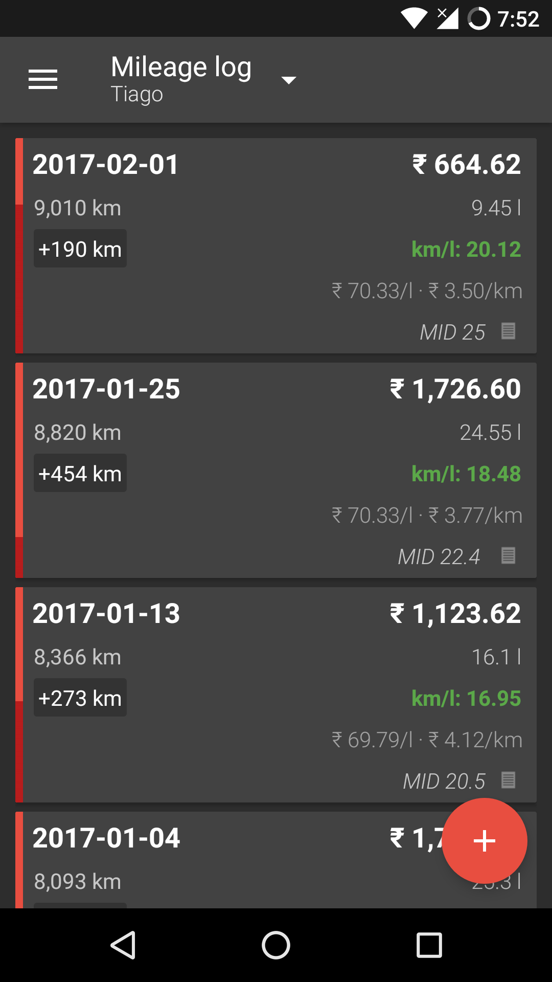

I did an early top up this morning just to check the accuracy of the MID with 95% of dual carriageway in Eco mode. The MID was quite happy at 25 KMPL for a 190 KM trip (3 short trips actually) but gave me a shocker when the actual FE was a mere 20.12 KMPL. I am quite disappointed to see 20% overstated numbers on the MID. Owners, please make note of this variance if you are taking the MID's FE figures for granted.
I ofcource use the old school of, kagaz kalam aur calculator (paper, pen and calculator)��
Thank you Nanofreak. This wasn't a planned post, I happened to notice the raw data file on my phone and a random thought hit me to put the numbers together. All this happened when my toddler girl woke up at 3:30am and went back to sleep while I was all sober by then [lol].
You drove 454kms before refuelling. Awesome for a petrol car [clap].My aim is to atleast cross 400kms for now

One of the very few perks of living in tier 2 city [:D]. I ran mostly on dual carriage ways with Eco mode during that refill.
Great. Seems like you drive mostly with AC off. Eco Mode and AC is a big No for me. Your graphs and table are so informative. Still would like to suggest that the variance should be measured more in % terms rather than only kmpl terms. Gives a better idea since at lower FE variance would also come down but at higher FE it would increase but % would be more or less same.
