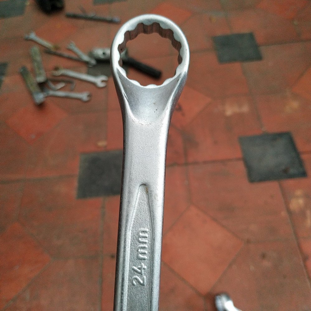

Bought the 24 mm spanner, saved a lot of mess this time.

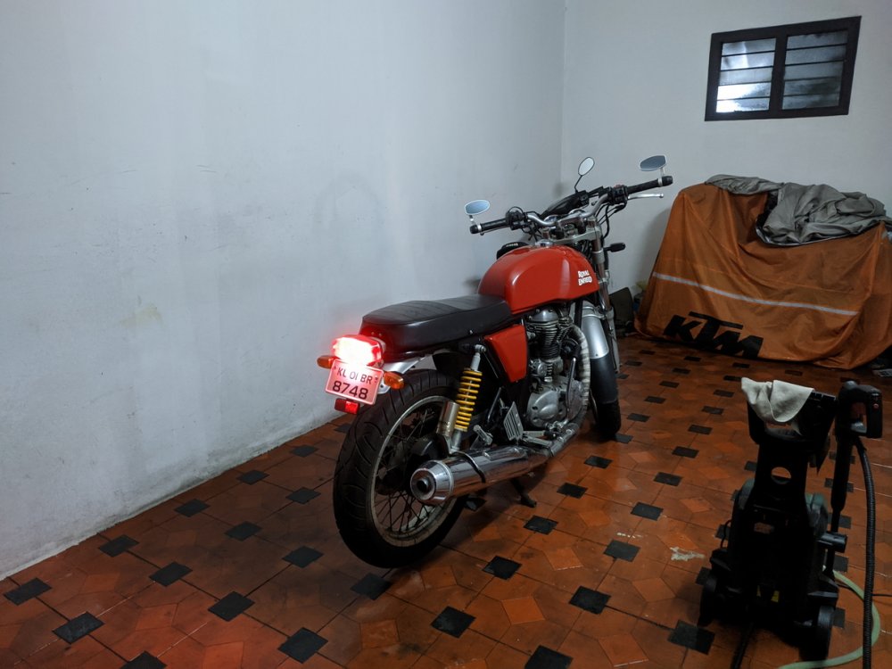

Finally gets custom LED tail lamps. Superflux/Pirahna LEDs. Bought from Kwality Photonics. Ultra Red.
60 red + 3 white SMD for tail lamp. Connectors for plug and play.

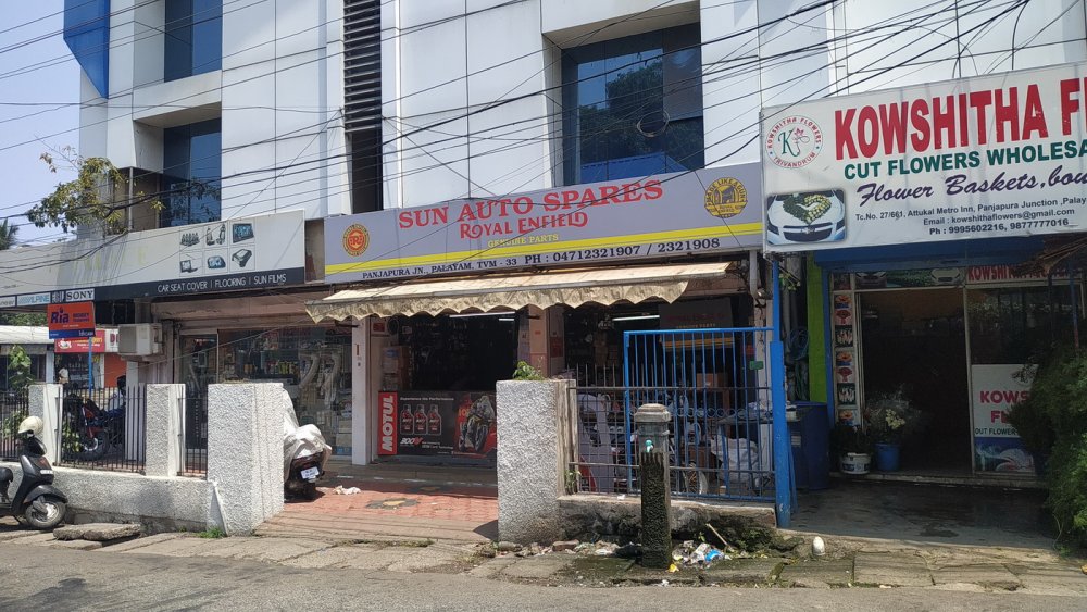

One of the oldest RE genuine spare outlet in Trivandrum, Sun Auto Spares. There is one more, Subha Autowares.

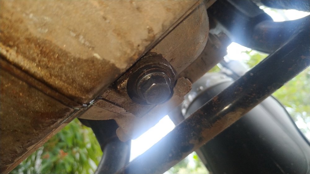

Oil Change:
First and foremost, park on flat surface preferably higher than ground level, so that there is easy access under the engine. There are hell lost of drain bolts you have to fight with.

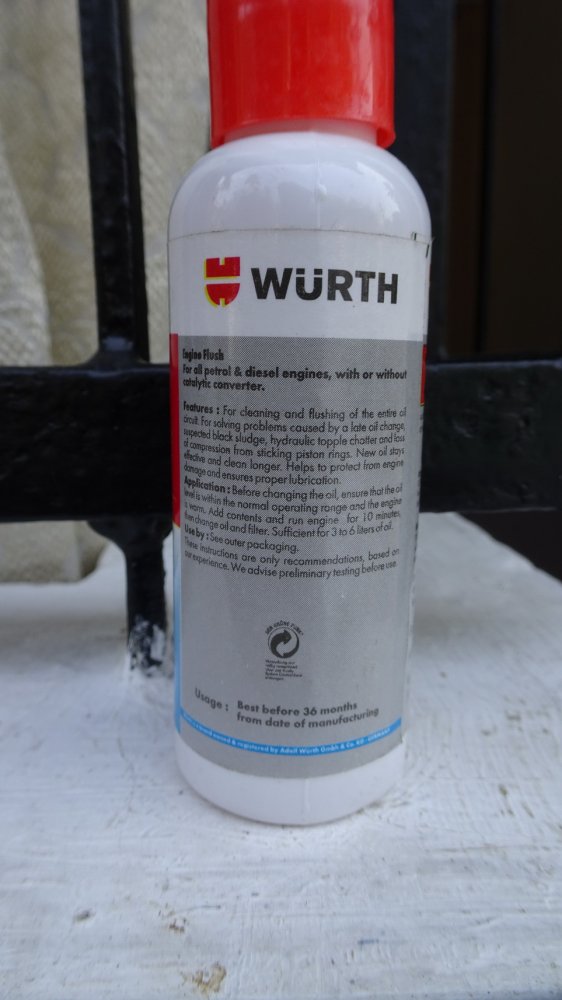

Decided to flush the engine as well, some left over flush from Duke's oil change. Wurth Engine Flush. ₹ 140.00 (MRP ₹ 150.00). Packing is not pleasing like the rival brands.

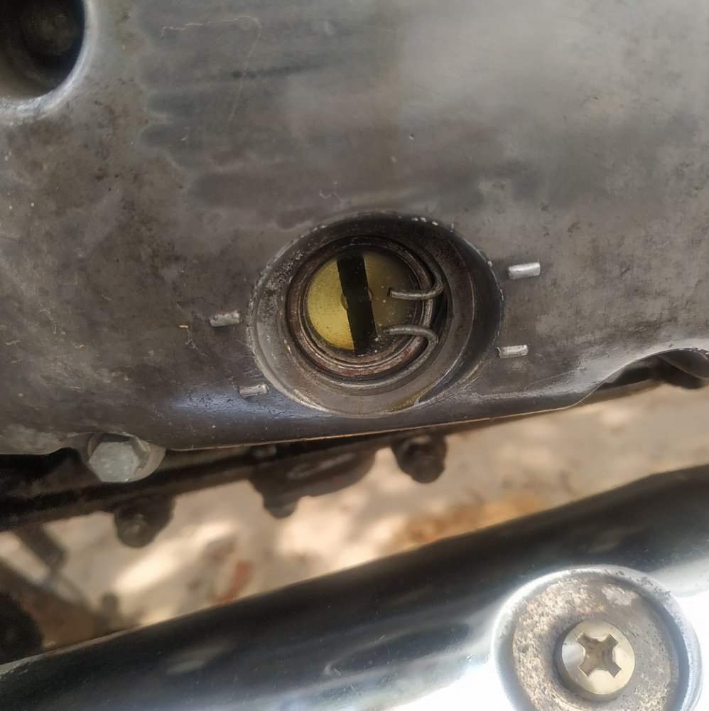

First roadblock is the filler cap itself. It messes with the wiring exiting the engine, which is another source of vapor leak and fixes with some sealant. Once open, pour the flush and idle for 10-15 minutes. Half the bottle would be enough. Drain when hot, don't let it sit.

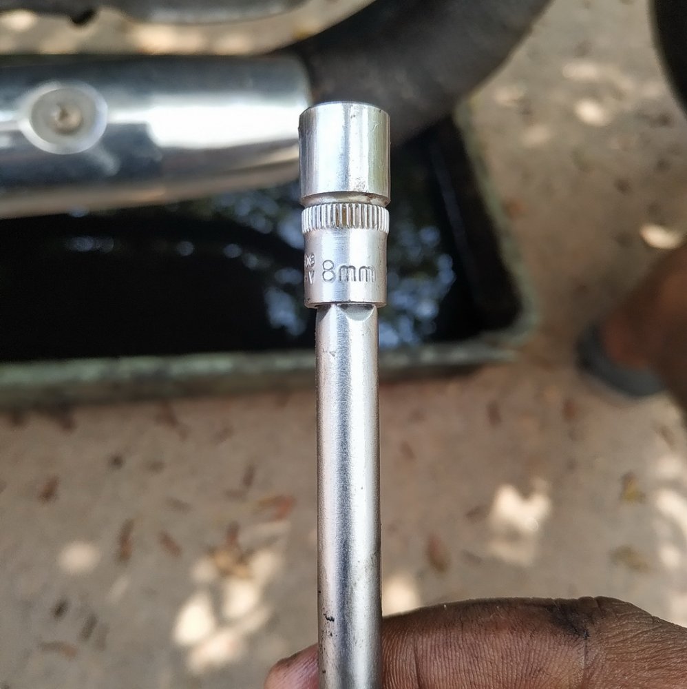

8-mm socket would do.

Clean the oil strainer and install it back. Install the drain bolts also back after cleaning. See the amount of sealant used by the mechanics. Didn't remove them since I forgot to buy sealant, will do the next time.

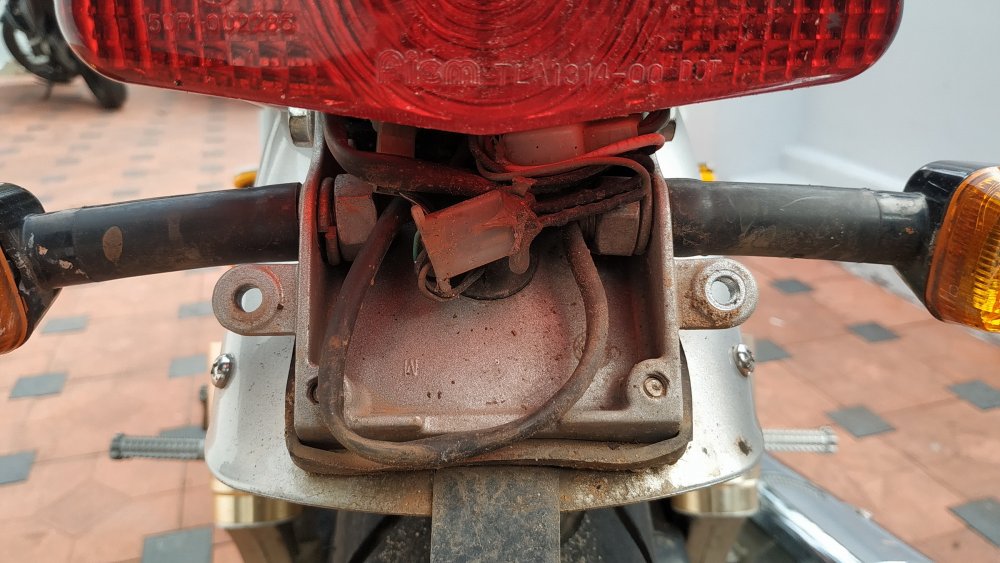

As expected, wiring punctured and cut off under mudguard. Common across RE models. Usually, the effect would have been either blown fuse with braking or indicator or all of them lighting up together when any one of them is on, like both indicators and brake light flashing with indicator.
Mended
and properly sleeved.

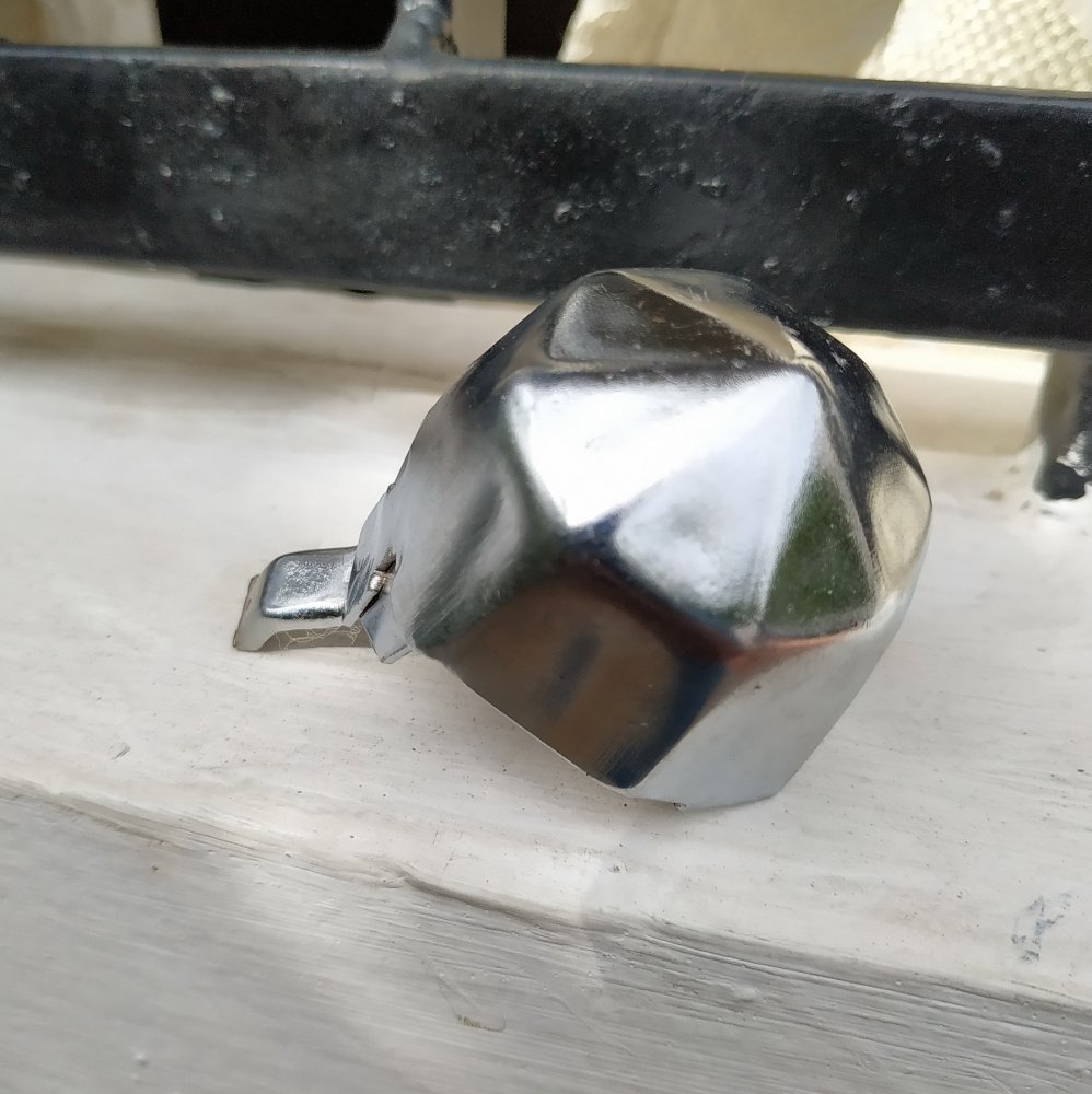

Clear lens reflector started showing quality. First the headlight glare shield fell off. Can attribute this to quality + the typical bone shaking vibes of RE. Just over a year and a half of use.
Removed it through the bulb hole removing the cup and clip. Actually, I feel it is more like cosmetic that functional since all the bulbs comes with painted/coated tip.

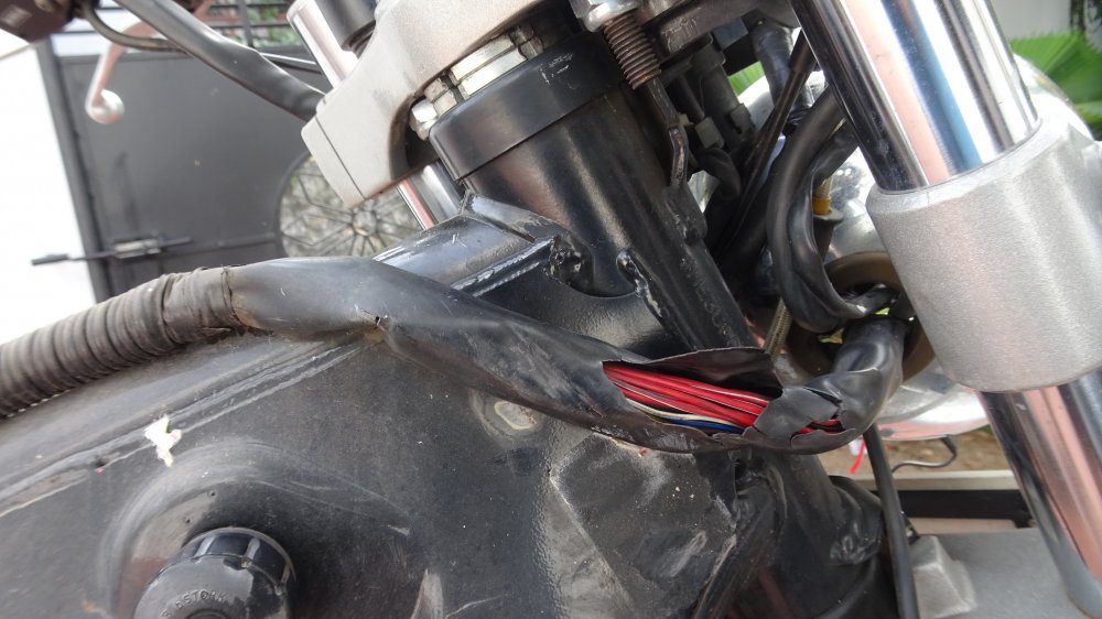

Wiring sleeve starts disintegrating like rubber parts. Wonder where in the world do RE source such third quality parts.
Removed tank for full access and next the fuel line itself was developing cracks.
Cut away the whole sleeve.
Bought a metre of the closest size corrugated flexible conduit hose.
Sleeved. Had to pull out the whole wiring from headlight to do it properly.

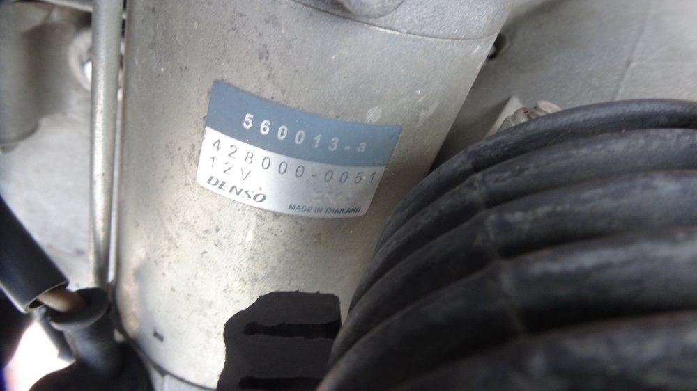

Denso Thailand starter.
