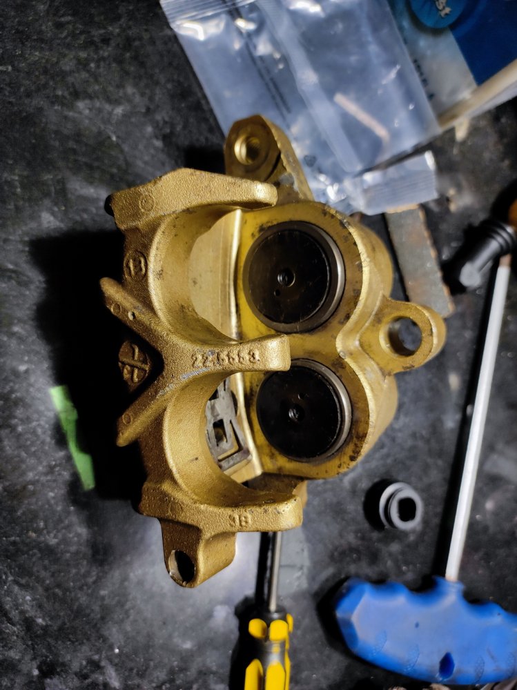

Brembo calipers

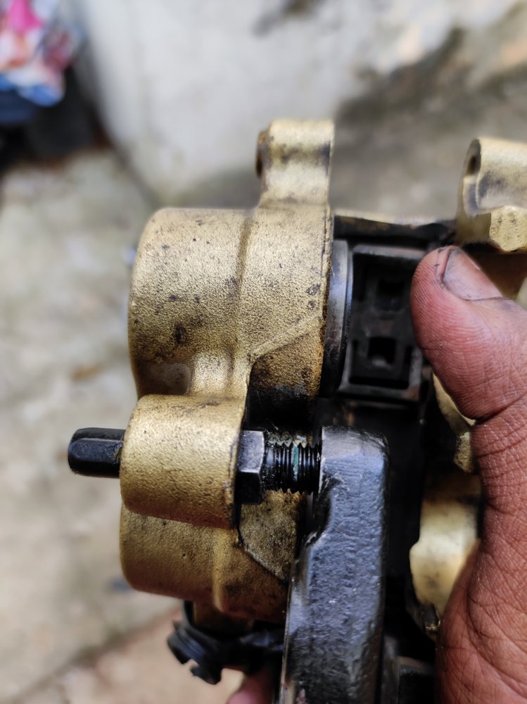

Removing the caliper pin was a bit tricky. It won't budge like normal after removing the clips. You have got to hammer it with a small screwdriver bit (nail here) for it to pop out.

You need something to support from bottom while hammering. Used combo of 1/2 inch extension for that.

Pistons got spacers.

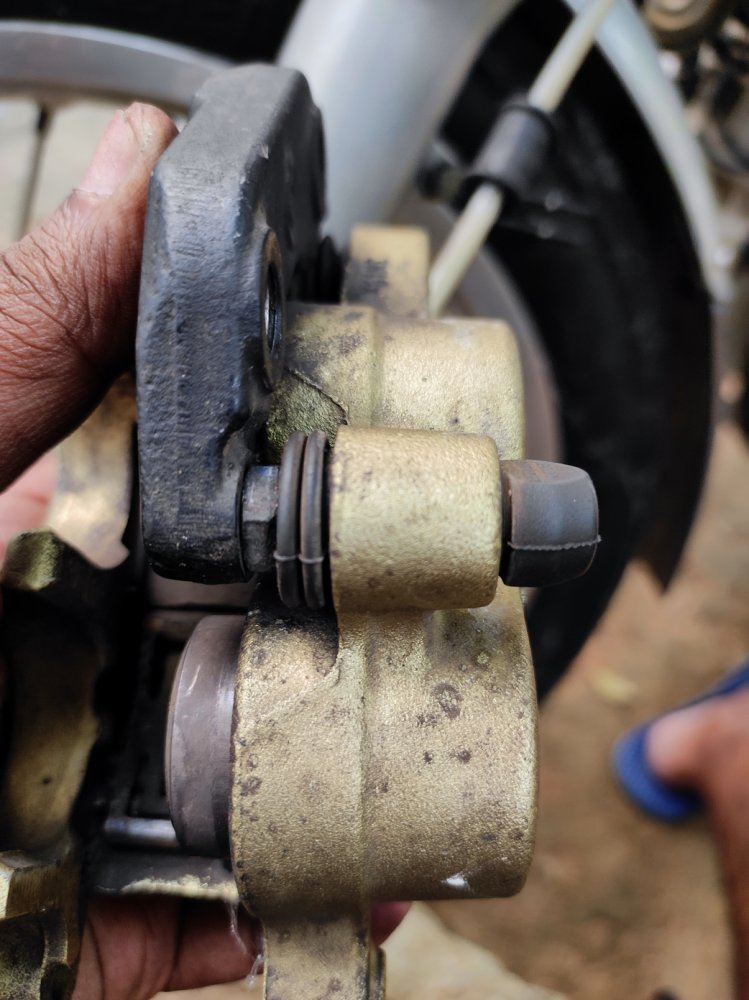

Road block. Caliper was jammed inside the rubber insulator/boots.

Rusted pin, root cause of the jam.

Villain of the show, the rusty guide pin.

Took some effort to remove.
Used 5-mm Allen key,
and jumbo pipe wrench.

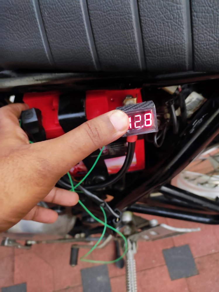

Renewed insurance with Acko. Total premium ₹ 3,373.00. IDV ₹ 1,04,523.00. Own damage premium ₹536.00, nil no-claim bonus. Third-party premium ₹ 2,323.00
Battery was discharging quickly, needs replacement soon.
and checked. Multimeter ran out of battery.
