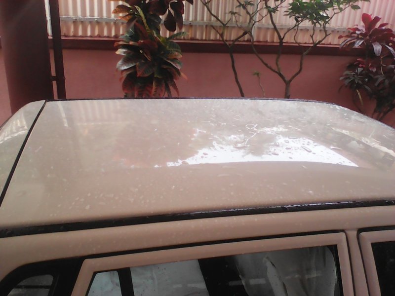

Small DIY of about 4 hrs on Saturday to keep my M- 800 DX 1998 Shiny::::::what you need is Waxpool (250gms) and 3M Shampoo ( 500 Ml) from Amazon costing Rs 345 and Rs 397 Respectively. Also some old clothe pieces are required. ::::::::Apply the wax slowly selecting small patches and use rubbing action, and clean it with another cloth and finally with Microfiber cloth to make it shiny. ::::This will remove all the carbon deposits and even tar sticking at the bottom too.::::::It is better to use Waxpool polish once in 3 months. 250gms of Waxpool lasts for 2 application.::::::::Finally clean with 3M shampoo and you will see how the car body is protected, one can see the water slipping and dripping from the surfaces:::::::when you get this done at 3M Service Shop, it costs you Rs 1500.::::::Attaching few photos
