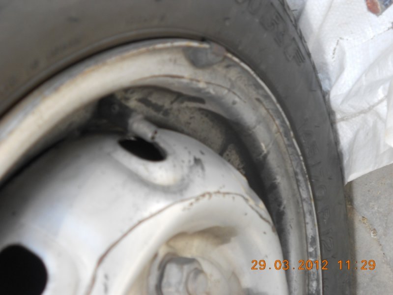

Guys i am getting these black dust kind of stuff on my M800 front wheels. When i checked with some drivers they said it bcos of the breakshoe. Still am worried bcos when i drive above 8okmph its getting more darker and i am feeling some shakeness while applying the breaks. Can u guys suggest me what could be the problem??? I have attached the pics also.[confused]

Looking at the condition of the rims, the shaky feeling could be due to alignment problems of the wheels. Get it checked asap. The lug nuts have dug deep into the rim, and I suggest that you get a set of new rims. Sooner the better.
The black dust does look a bit too much, but maybe it's because you haven't cleaned it for a while. It's caused by the brake pads, as loboprashanth said. However, I would suggest that you check the pads and their clearance with the disc. Make sure they're not rubbing on the discs - in that case your pads would wear out real fast and your braking efficiency would be seriously degraded. Plus, there's a risk of the disc warping at higher speeds. due to heat.

Hi Nimrod,
Alignment of the wheels is absolutely fine bcos i checked it twice with diff. service stations. Both the sevice guys said its bcos of dust from the break pads as you guys said. But the fear is the shakeness only at high speeds. I f i drive around 50-60kmph and apply the breaks i dont find any issue. But anyhow as you said i'll check the rubbing issue once. Also planning to change the wheels to alloy's. Waiting for some cash inflow. Can u guys suggest some best brands and design for M800 as i am more concerned about the look too....!![glasses]
