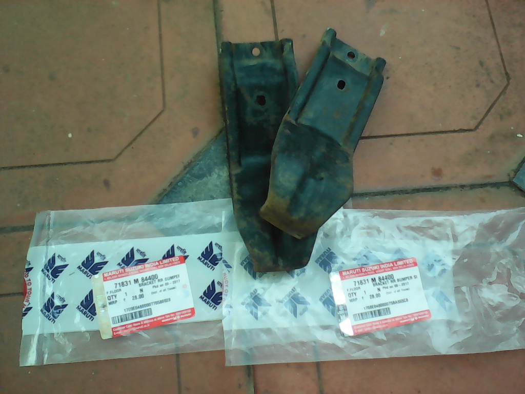

Small repair work in M- 800 at the Rear Bumper is expensive affair but better than replacing the new one with another within 5 months.
I did replace the rear Bumper in May 2017, Bumper cost was Rs 1200 and fixing cost was Rs 200.
Last week while I was going slow near the Veggi Market, some Idiot Bike rider overtook me from left and instead of hitting the pothole, he put sudden brake thereby hitting my rear bumper and ran away. I took my car to FNG and he said the left bracket broke and temporarily fixed the Bumper, charged me Rs 100 and asked me to come after 3-4 days, so that he could get the new bracket and fix it.
Yesterday I did go there and on opening the Rear Bumper, observed that the left side bracket screw broke due to rust. However I asked him to replace both brackets, each costing Rs 28 since he brought 2 brackets by my luck. He had to use gas to cut the screw struck in the hole, paint the portion with car white paint since it became blackish, wait for about 1/2 hr, also fixed a crack in the bumper by M- seal and fixed the bumper and charged me Rs 56 for the brackets and Rs 200 for the service rendered. This FNG is just one km from my place
Of course I will not use my car today since M- Seal has to dry out completely and has to become hard like steel. Of course no vibration so far and hope it will hold it for some time.
photo one shows the bracket with broken screw and photos shows the part no.
