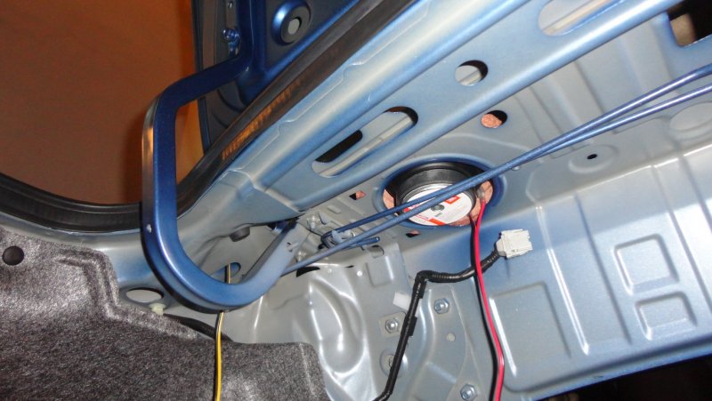

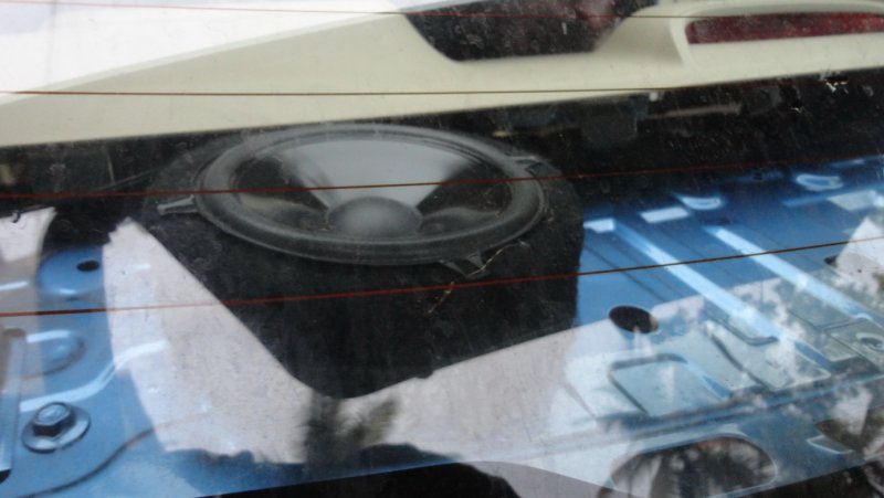

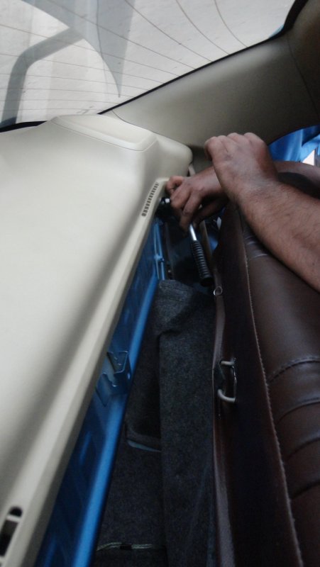

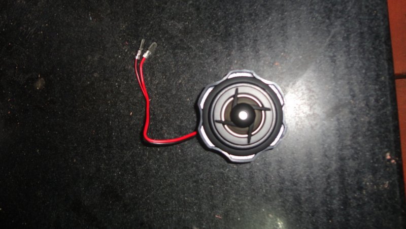

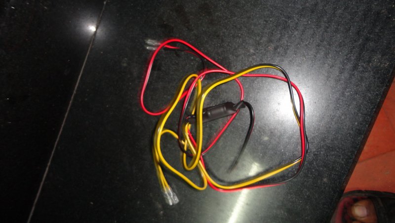

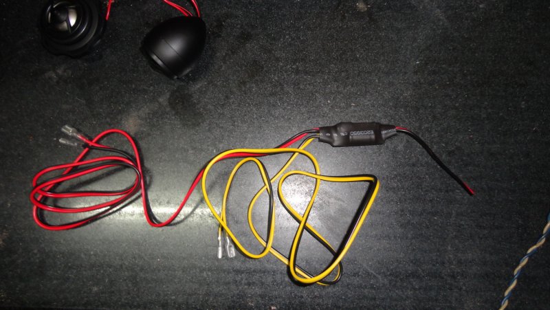

DIY Rear Speakers Change

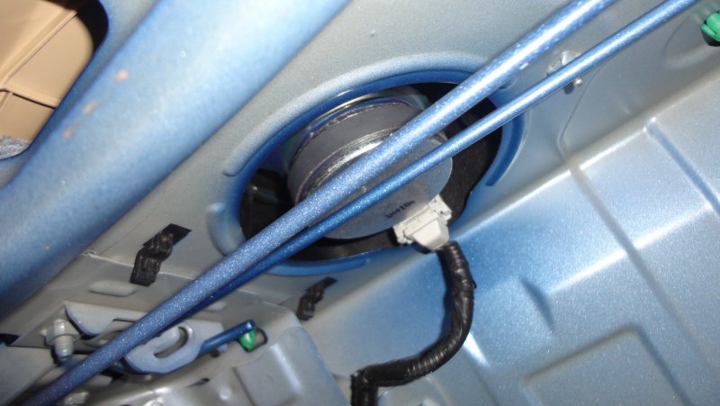

For completing the Audio setup in my car , i had to change the stock rear 4" speakers of Amaze. There was a Major problem with that. Only 4" speakers can be used on the rear of amaze because a metal rod is passing right under the magnet area and any bigger size will have a deeper magnet and hence it wont fit.
After a lot of searching finally came up with this.
JBL - CS-5C 5 1/4'' Component system. This was available in Snapdeal and it isn't available now. Probably i would've bought the last piece. The production of this model is being stopped .

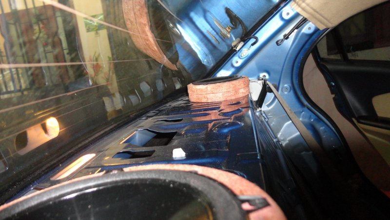

Starting the DIY[evil]

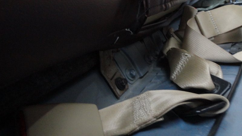

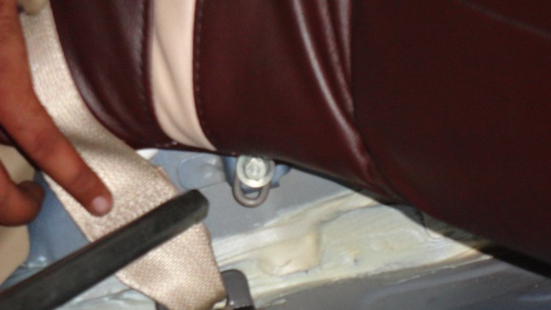

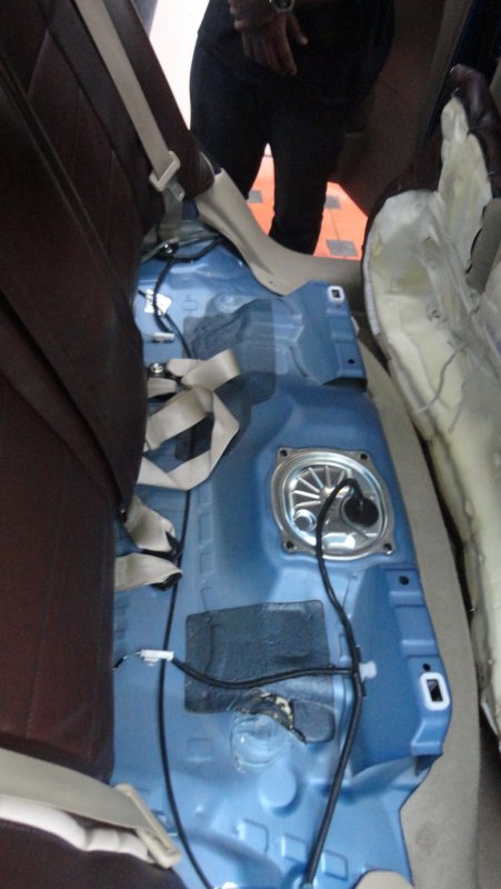

Remove the Seats
Remove the Rear parcel tray.
Unscrew the bolts .

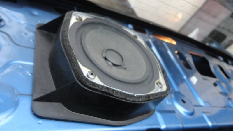

Tadaaah !! [frustration] 4" crappy OEM

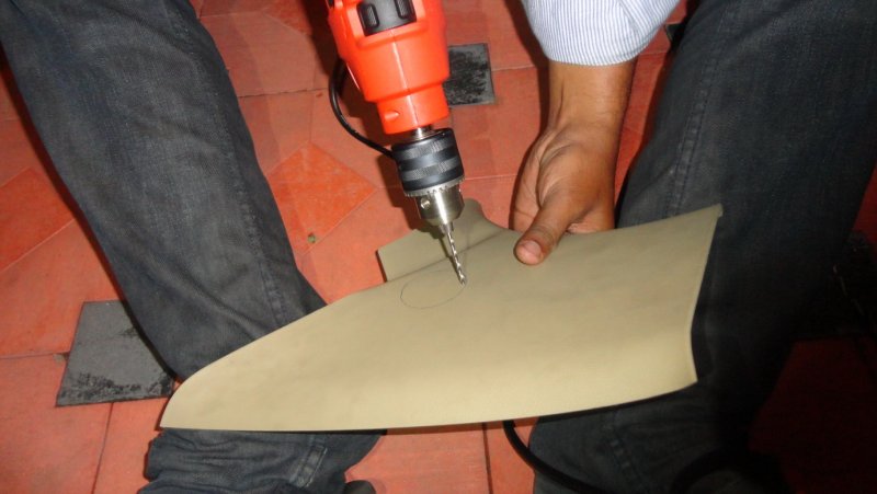

Checking the size of the 5-1/4". It was very tight.

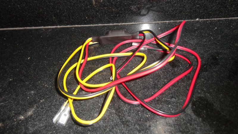

Crossover
Tweeter's
It can be mounted either of the two ways shown here.
Very tight clearance.

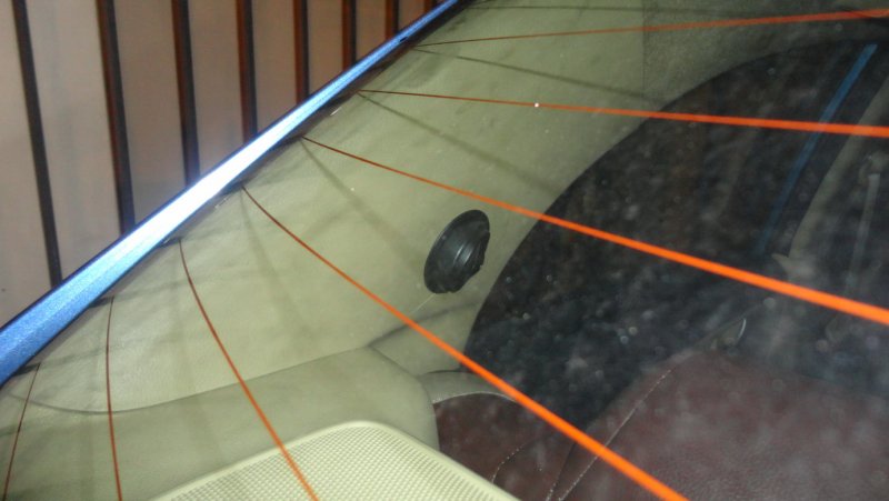

Drilled the tweeter's in the C panels.
Perfectly Fitted.
The overall feel inside the cabin has been increased phenomenally. Now i have got 4 speaker's and 4 tweeter's [evil]
