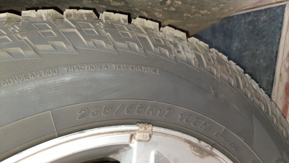

Thunderbolt also got a new set of shoes. While the Current Falkens had some life left (esp rear ones), Dad insisted he needed new tyres before 1st rain.
Falken AT was not available due to Import Bans, so Went with Yokohama Geolander AT. Was lucky to get the good old Safari type pattern and not the thin wimpy pattern on so called new ATs or HPs
New Yokos compared to Falkens (Aged 60k)
Notice the wear on front tyres (Top) vs the rear. XUV uses front tyres much more aggressively.
Stock size
The tyres costed 12.5k a Piece. Quite Expensive I felt.
Especially since safari tyres (16 inch) cost roughly 7 to 8k all Brands. Have the same Rolling diameter and actually a taller profile.
In that sense, XUV tyres (17 inch) use a smaller profile and should use lesser rubber to make. So should've been CHEAPER in that regard.
Some weird logic used by Tyre companies to make profits.

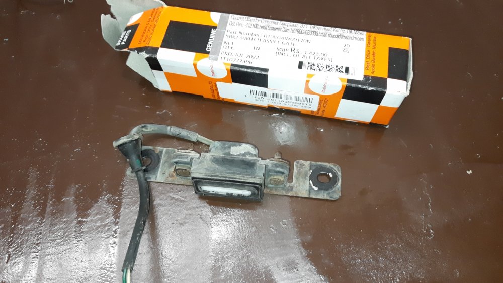

Played around with xuv parts.
The tail hatch button is a simple 2 button push type. There's a copper pin which joins 2 contacts together. Can very well be opened with bell switch.
Once the rubber tears, dust & moisture will quickly kill the switch. Its definitely very overpriced at 1200 a pop.
Here are the pics-
The door latch is a bunch of cables & levers. Salvaged one actuation motor. It's in a sealed housing. The motor moves a lever when provided with 12v DC.
