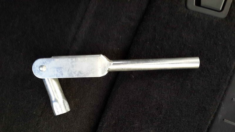

Copying from my own thread:
My Red Highway King: Tools
The story of my Winch access tool.Do you have it in your toolbox?
Within a month of purchase,I noticed the winch access tool missing in my car.It is required to lower down the spare wheel in case of puncture.The odd thing was it was clearly mentioned as "provided" in the owners manual.I started complaining to the customer care as well as the Auth.service centre.At first they failed to understand what actually is missing in the tool box.
When I persisted and showed them the manual,they clarified that newer xuvs dont come with this tool anymore.I demanded this tool to be provided to me because the owners manual says so.
Their reasoning was that its not required anymore and moreover they don't have it in the stock.Later on after many complaints to the cust.care ,Winch access tool suddenly appeared out of nowhere,in the showroom.The story ended with me as a happy customer with the complete tool box,Thanks to mahindra customer care.
Obviously you are missing couple of tools here.

Quite a Hawk-eye find doc. Yes, The tool is missing from my XUV. You are lucky to have one rare tool in your collection!
Thanks.
Yes I am too fond of tools,and I never wanted to miss any opportunity specially when I paid 16 BIG ONES from my hard earned savings.

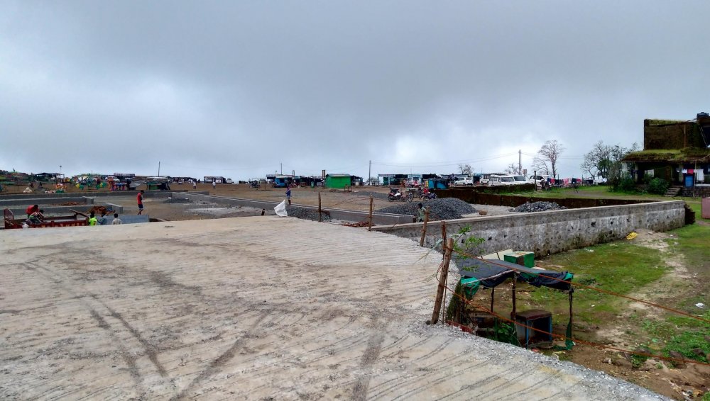

Massive Construction work going on by Guj. Govt.

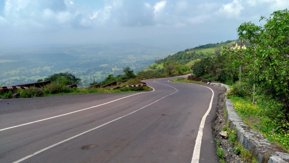

The fun is multiplied due to very nice and well laid roads. But you sure need a powerful car. Can anyone help calculate how many degrees is this slope? (Note this is NOT the slope I was talking about before)
The road does a very good job of hiding the steep slope. its actually hard to walk here.

Massive Construction work going on by Guj. Govt. View attachment 264934 View attachment 264935

The fun is multiplied due to very nice and well laid roads. But you sure need a powerful car. Can anyone help calculate how many degrees is this slope? (Note this is NOT the slope I was talking about before) View attachment 264948
The road does a very good job of hiding the steep slope. its actually hard to walk here. View attachment 264949

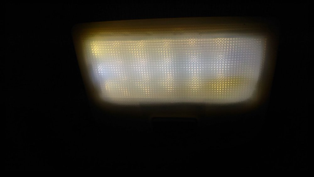

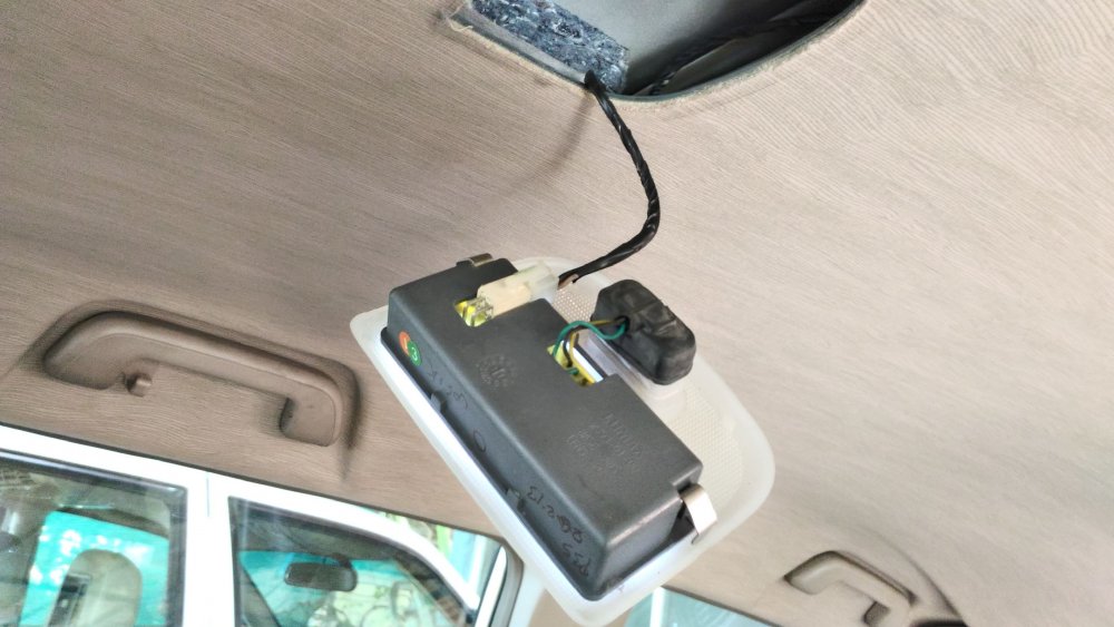

Finally Found time to Repair the LED dome light (The repair was done in 2019 BTW. Writing the guide now)
As you see here, Few LEDs have conked off. And Other become dim.
The Light is held on by Clips. Take a bit of Effort to remove.
The Kind of Insulation done by Mahindra-
Finally The light is in hands. Lets Open it up.
To be Continued...

Opening the lamp took time as everything is glued shut and has no Screws.
Finally we can see that LEDs have gone dark. Probably due to Heating.

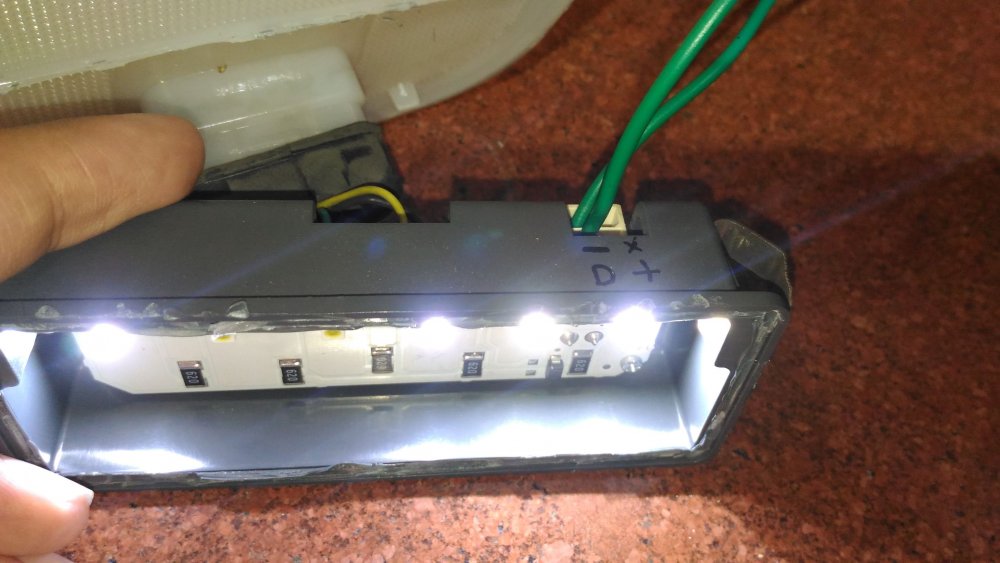

And Why Would'nt they? The PCB is barebones Plastic and not even MCPCB which we get in 100Rs worth LED bulbs. Pathetic quality and Design of the lamp. Being Enclosed in Plastic casing with no Vents or Heatsinking further exaggerates the problem.
Testing it using a Transformer. One see the bad LEDs.
Figuring out the Light took some time but basic Layout is very simple. Just Regular Resistors and Diodes. No PWM driver IC used. The Lamp is being sold for about INR 900 which is Horribly Overpriced I must say. The BOM of this light is below 100 Rupees.
D Stands for Door switch. the X is not connected anywhere. Its a basic 3 wire setup, being fed directly with 12v.

And being fed by 12v. It means I can go with regular 12v LED strips rather than custom made PCB. So I did.
And So I did. In my Typical Trademark fashion to achieve 4000K Color Temperature. A little bit of Continuity testing allowed me to Figure out the solder Points.
Testing at home
Testing done!
A diode was needed to Prevent the Backflow of Current to Door switch.
Ready to go inside the casing.
not wanting to go with Fevi QUick for Future Upgrading, Hot glue came to rescue-
SO there you have it. 900 odd rupee (Not in my books) Light repaired essentially for free. I will post the working shots tomorrow.

Even before popping it open, I felt it was badly built, like from the first gen Indica era. Overlapping wires could've been avoided and black or white would've been neat. Definitely overpriced for the quality and shoddy for a million and half plus worth SUV. With 5050 SMDs, now it's like 54 times the stock SMDs [evil].

Adding the Pictures of Dome light Repaired. The Camera Does not pick up what Eyes can see. In reality the Light has become Slightly Brighter and fare more even (Due to higher nos LED diodes) than before.
The color Variation can be seen only if you know about it.
An Boosted HDR to give you an Idea of Warm-Cool mix of LEDs.
