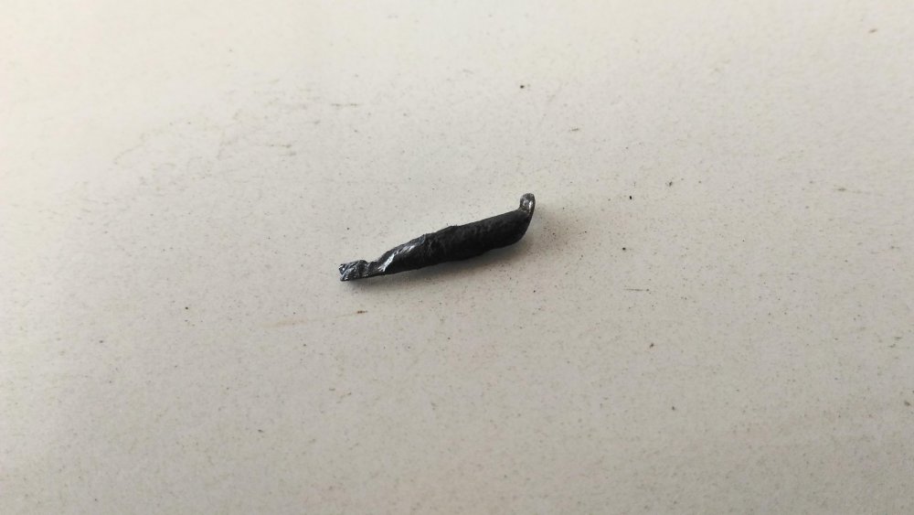

The Falkens suffered their first puncture after rolling for 41K Kms. It was a nail so I can't blame them.
Repaired the puncture at home and completed Bombay trip. No Air loss.
I must Mention the tyres are EXTREMELY tough. It was very hard to get the reaming (Drill) tool inside. Even If I put my entire pressure on it. Man! Sweat was dribbling from the tip of my nose. And it took a good 20 mins to finish the job.
