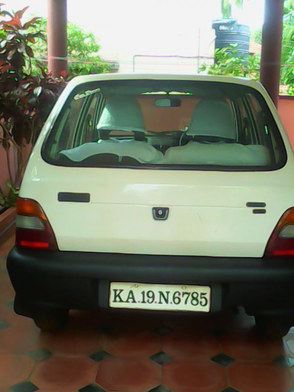

Underbody coating My White Angel M- 800 DX of 1998 Model.
My White Angel M – 800 DX of 1998 Model got Antirust Under body Coating and also Floor coating besides cleaning of Door Pads. It took 2 ½ days for me from 15th May 2017 Monday till 17th May Wednesday Noon.
Before sharing the details and photos, let me first thank swiftshashi and Sumitsinha, the two enthusiastic young members of TAI, who gave me lot of suggestions/ Tips on the subject which was discussed for few days under the topic – Technical Issues and Solutions.
Mangalore is a nice city with many persons having latest and expensive cars and very few old persons like me still try our best to maintain our old Maruti – 800 cars. Of Course swiftshashi and Sumitsinha are exceptions who made history among the old Maruti Car owners; Of Course there are few more enthusiastic young persons in the TAI. Majority of the Car service centres make roaring business here on services and it has become a lucrative business. However I did struggle to find a suitable Auto shop here, having the 2 stage lift facility for washing and with spray gun, however Auto Service Stations which I approached started quoting exorbitant rates just for one coat either with 3M or Wurth, as the market here is controlled by the lobby of these 2.
Finally I could find a place by name NANDI MOTORS, a Bosch service station, who agreed to do only the labour job with my materials and their rates, seemed to be reasonable to me compared to others who quoted more than double for the same work. This Auto shop started by 3 partners about 10-12 years ago, have about 35 workers, covering servicing of all kind of cars, Painting work etc. However it is not organised properly like MASS and everything is hotch – potch here and one has to sit there to get the work done properly.
After reading few articles and also interacting with swiftshashi, I took the decision of going for Zinc Chromate Primer of Epoxy of Grey color, Gem Guard make. My guess as regards purchasing of 1 litre along with Hardener ( Rs 332) and 1 litre of Epoxy Thinner of Gem Guard ( Rs 223) was sufficient for a primer coat for underbody and for Floor area. Total cost was Rs 621 along with 1 litre of Turpetine for cleaning of their Spray Gun Nozzles, Brush etc and not for adding to the Tufkote.(Bill attached ).
I got Tufkote 4950 Underbody coating of 2 Litres costing Rs 851 from Mumbai. ( Bill attached). It was not diluted while applying and only about 1 ¼ Litres was sufficient for underbody coating and for the Floor area.
Since I got the underbody coating done 6 years ago ( 3M of one coat done at Mass Mandovi) and also my car is well maintained for all these 19 yrs, except some rusting seen at the chassis, there was no rusting at all anywhere at underbody or on the Floor area. Even there was no rusting seen at door panel areas, except little dust accumulation, hence I did not do any spraying at Door Panels after seeing the condition of the Door panels and also the Auto owners were pressuring me to take out my car at the earliest as on the very first day from 10 am till next morning the car sat on their lift and they had to postpone washing of other cars the next day.

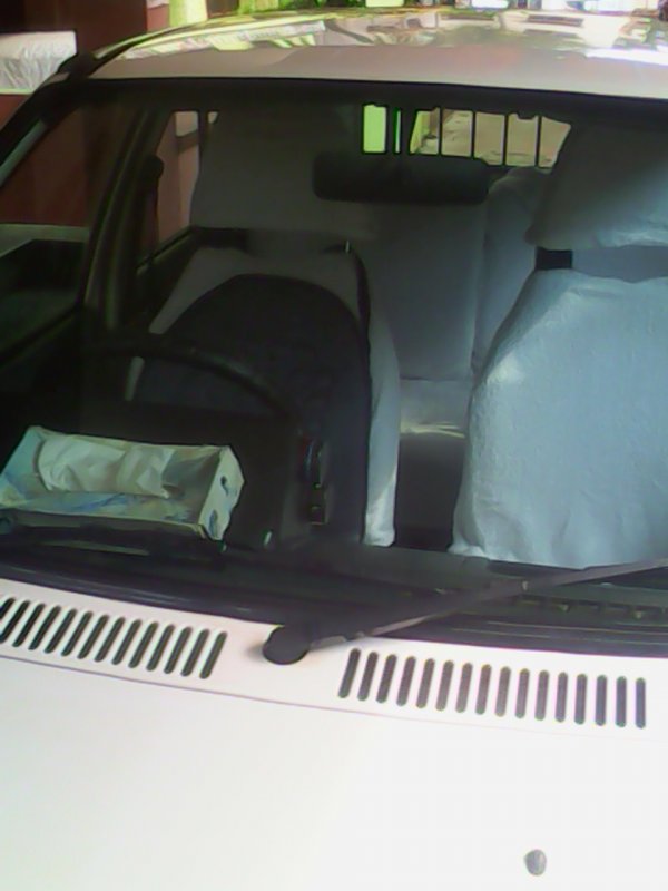

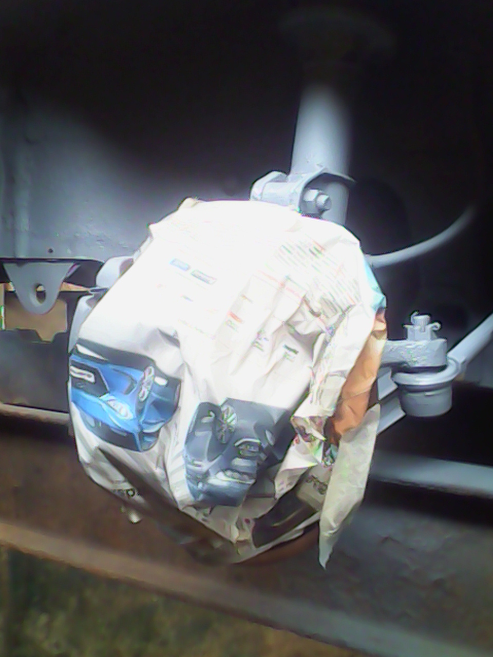

On 15th May Morning, the car was washed thoroughly by removing the wheels ( and not fender liners as the Auto owner was bit upset that I stayed there to witness the working done ) at 9.30 am and till 2 pm ( about 4 Hours ) we kept it for drying by blowing compressed Air and made sure there was no moisture at all before we applied the Primer coat by Spray gun. It took just one hour to apply primer coat and within ½ hour it dried, however I insisted them to start the TufKote Coat after lunch only. So the Tufkote Spray was done from 3 pm to 4 pm. They were not prepared to cover up the half door areas by plastic sheets ( I took some plastic sheets ) to protect it from reaching those areas due to wind ; instead they sprayed some diluted Diesel , so after completing the Spray work they could wipe it up and clean with soapy water etc
The Wheels were taken out on my insistence; however the Auto owner was not prepared to remove the Fender lining saying that they do the undercoating without taking out the wheels and fender lining for other cars all these years. The Auto owner asked them to fix the Tyres and take out the car from the Lift after completing the Tufkote coat but I strongly objected that he would be responsible for any damages. So unwillingly the car was left on the lift till next morning.
Though on 16th May I reached the place at 9 am and the car was taken out from the Lift, the Auto owner gave the Mechanic to remove the seats and Brush service man only at 12 Noon to start the Brushing work on the Floor area (He took the Front 2 seats and the back seat only as there was no necessity to take out the Back seat rests). It took hardly 30 minutes to apply Primer Coat and then after lunch only I asked him to do the Tufkote coating work by Brush and it took only 30 minutes. We closed the doors after 4.30 pm and left it like that for drying till next morning.
On 17th Moring, he fitted the seats and took out the Door panel pads and took the car for though washing. Since it was damn hot, we did not wait for it to dry fully, but fixed the Door pads by applying some greasing etc. The Total Bill came to Rs 2070 ( Bill attached) I felt it is reasonable, compared to other Auto shops who quoted me Rs 4000 plus.

On 18th May Thurday, my DIY started to clean up and remove any left over blackish marks and apply waxpol to the Body to give a shiny look as usual, by spending about 4 hours.
Just attaching some photos clicked during the work.

If you get Zinc Chrome Epoxy primer, it is good because it gives strong bonding to the metal. Then applying 4950 helps. Worst come worst, you can give 2 coats of 4941 if you don't get Zinc Chrome.
Even 1 1/4 litres of 4950 was sufficient ( without diluting) for my M- 800 underbody and Floor coats. Im left with 3/4th can of 4950 and shall give to any friend who will do underbody coating in Mangalore. Since it is opened, it can not be transported, otherwise I could have sent it to you. Because the product to be used within about 12 months after opening the can. Who knows it may become harder later or may be it is their marketing plans and For safety reason they send it by Road transport only.
