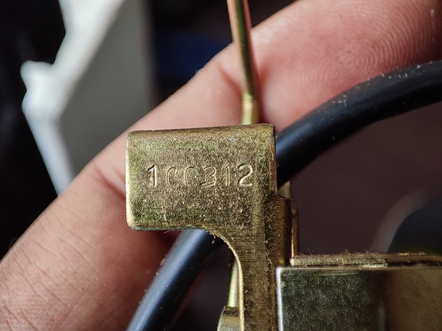

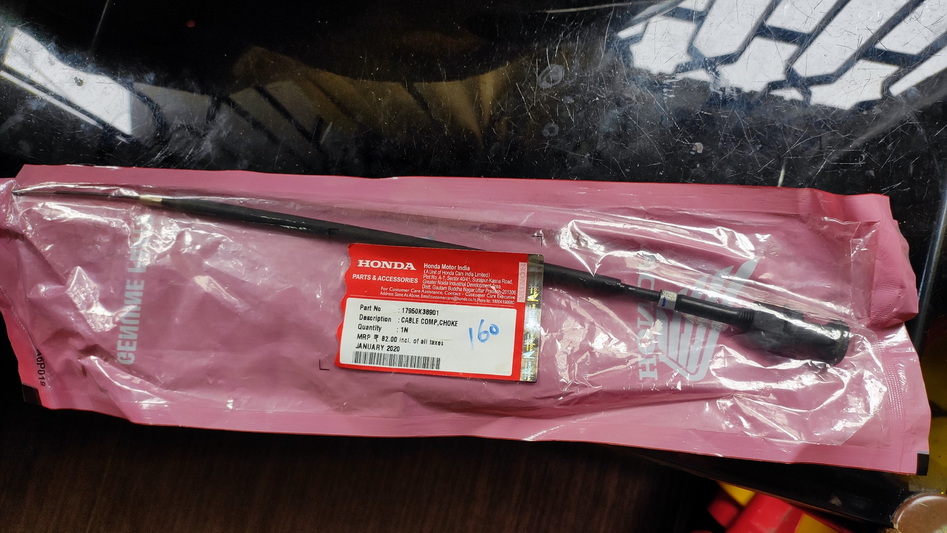

After some homework, found Honda Unicorn 160 choke cable had a similar end and bought it. Got it from Autoland, Bakery Junction.
Choke Cable - Honda 17950K38901 - ₹ 82.00
It was just over a foot long.
Met with a roadblock. There was 3.5 cm extra length, which made huge free play.

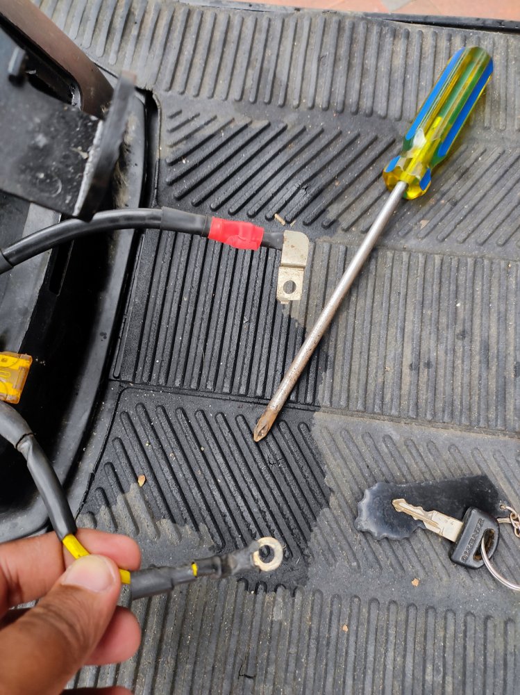

Replaced battery terminal with proper one.

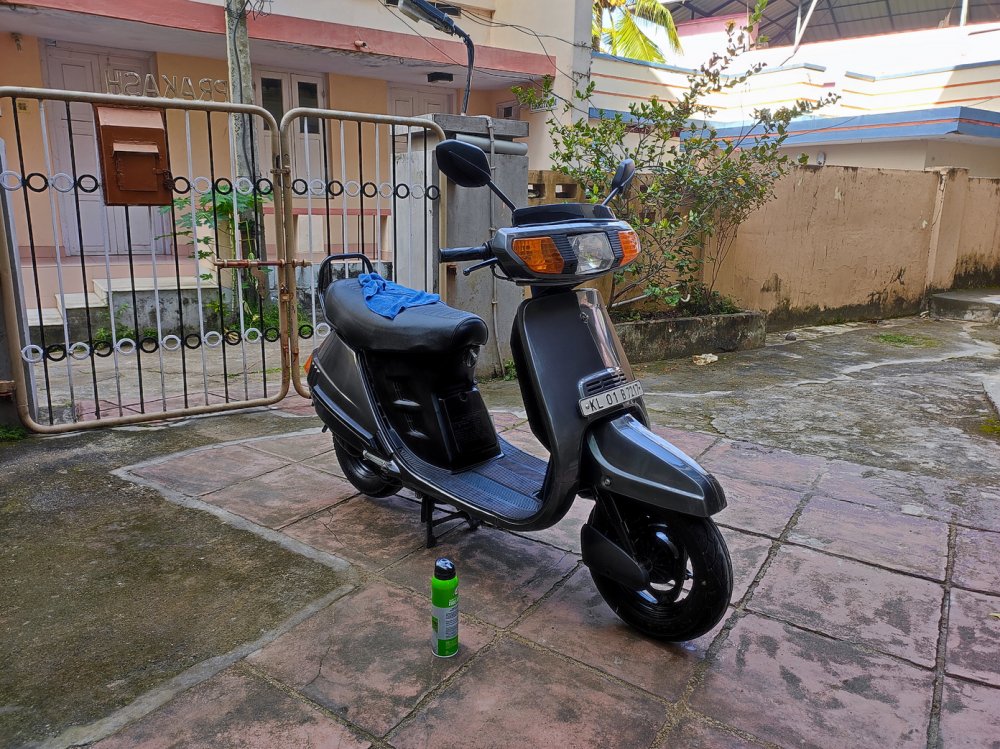

Washed thoroughly.
Got an Esdee Matt Black can.
Painted the rear rim and externally visible black parts. Body painting was intact from last test, with some minor scratches. A quick polishing hid them well.

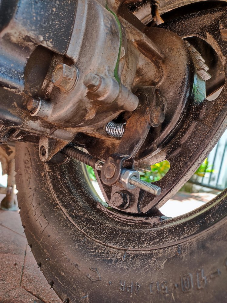

The brake lever was not returning properly and had no clue where the brake return spring was located. Couldn't find one on the cam or the brake lever. Checked under the Dio and found where it was supposed to be. Dirt accumulated over time. Missed those even during the retest prep.
Got a genuine Honda spring.
Honda 43472-KPL-900 - ₹ 5.00
Cleaned all the mess before install.
How it goes in.
Works perfectly now. Needs a proper pressure wash.
