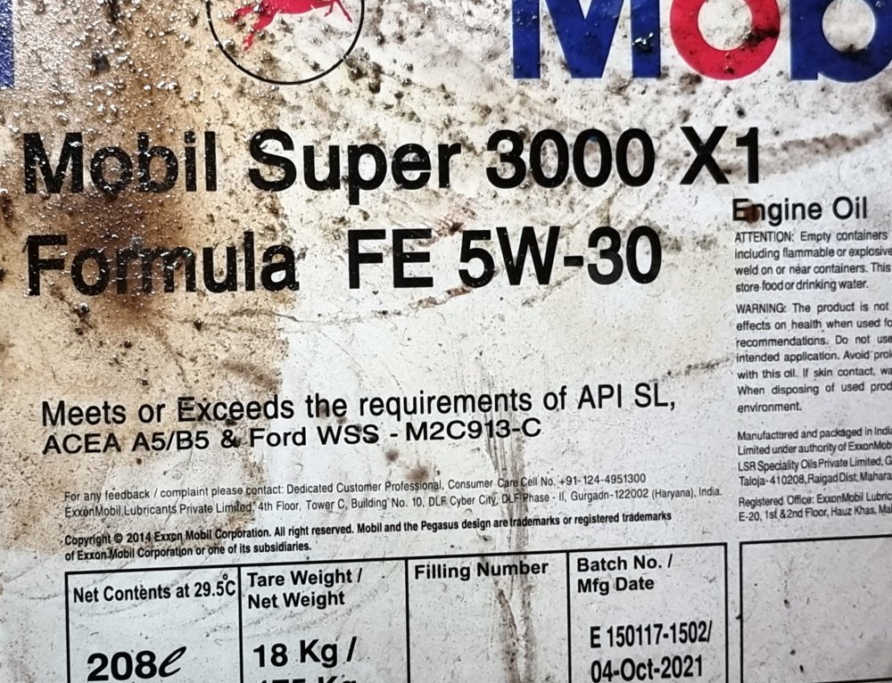

The tenth service of 90,000 Kms was done in May 2022. The service bill was Rs. 20,192/- and for the first time Shell Oil was not available, instead Mobil Super 3000 X1 was used. Apart from the usual inclusions of Oil Filter, Diesel Filter, Air Filter and some other minor aggregates with Alignment and Balancing, the increased price was due to bent Brake Caliper Pins which had damaged the Brake pads as well. Also, due to the debris which had accumulated between the radiator and condenser, both were removed and cleaned along with the fan and intercooler. Since it was already 90K Kms on the odo, the coolant was completely replenished with new for peace of mind.
Picture of the oil barrel
