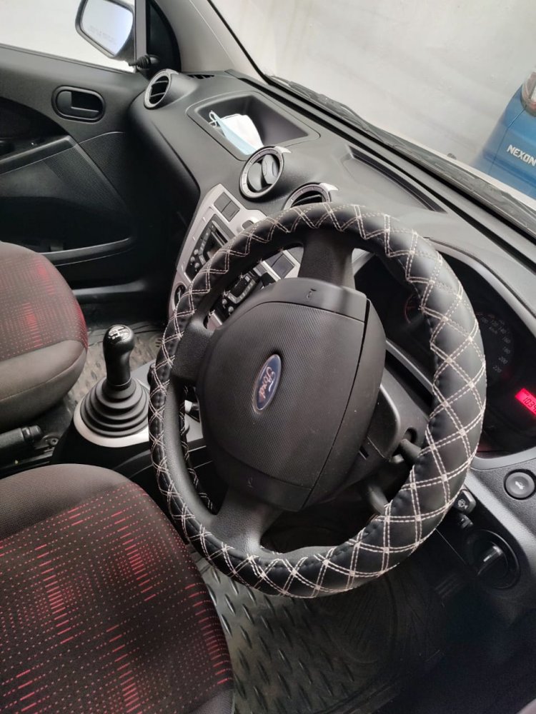

Pictures of the interiors
Original seat fabric held up all right, even without seat cover .Please consider it has already lasted more than a decade!!
Ford had used good quality plastics. Even the knobs haven't faded after remaining parked in the sun for more than a decade!!
Boot opener is on passenger side footwell. That's odd.
Even more odd is wiper stalks on the right hand side

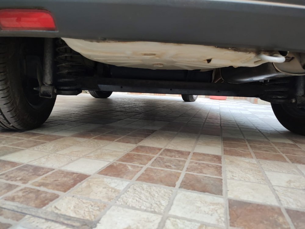

Pictures depicting the present condition of Figo, after doing lots of vacuum cleaning, removing cobwebs, external body stains and polishing.
Christmas tree shaped back lights.
Straight ,clean and simplistic lines on the body.
Ground clearance is 170mm
Rear tow hook is permanently attached like this only, although not visible without bending to look for it.
Fender indicator is stylishly shaped
Cavernous boot 284 litres
OEM mat on top of carpet
Just look even this Ford assistance sticker hasn't peeled off, nor has faded one bit, even after standing in sun for 11 years !!
Rear reflectors are low down on the bumper and don't have bulbs in them.
Petrol tank cap.
