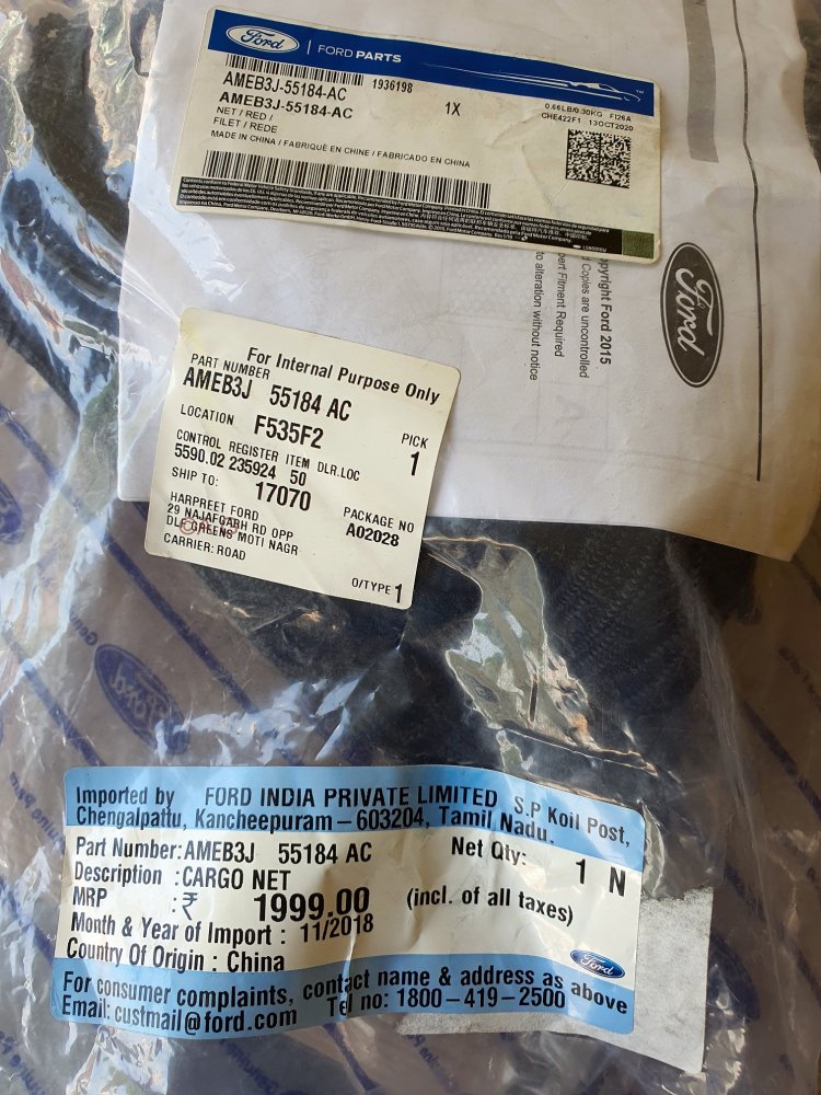

Another add-on is the Ford’s official cargo net which is very good at holding items inside.
Even this package comes with installation guide as well
Installed and put to use for holding the duster and umbrella
