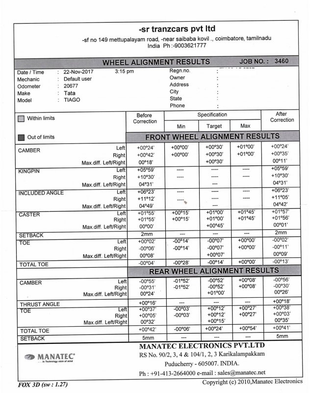

Regular checks were done; tires rotated, wheels balanced and aligned:
Invoice Copies: I was charged for wheel balancing citing it's not part of 7500KM service. However, they wrongly charged for wheel alignment as well which was taken out with a credit note. My final payable was Rs 728.

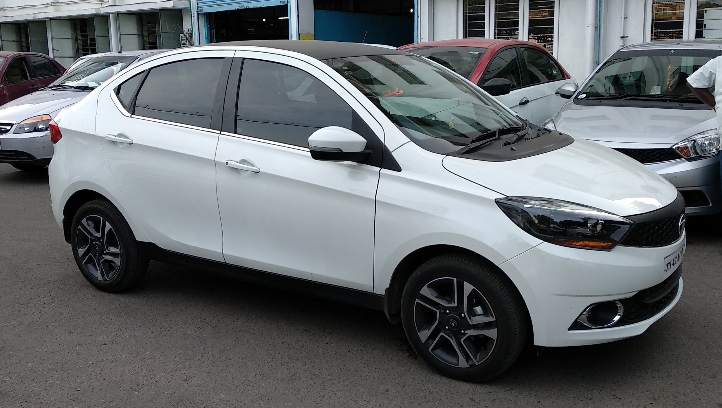

And this hot white Tigor:
