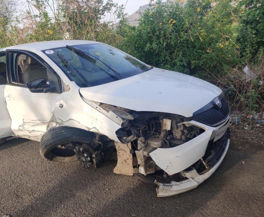

Few days back my car has suffered from severe dents on RHS doors & front bumper at a signal, Ethix Skoda still not tied up with insurance Cos hence not able to do the insurance claim cashless hence despite spending one month
at Ethix car needs to be given to the Viraj SKODA ASS, Baner. Pune.
