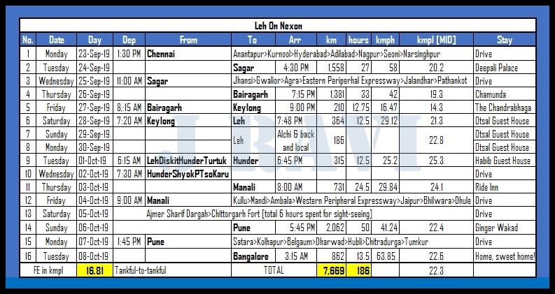

I never opened the bonnet in the 7,669 km-long Chennai>Sach Pass>Ladakh>Chittorgarh>Bangalore drive as there was no need. Perhaps, the humming noise at idling might have originated during that long drive. Even after reaching home, the first time when I opened the bonnet for cleaning the engine bay, the engine was off. Then, after a couple of weeks, when I fixed the clamps of the portable pump cable with the battery terminals to inflate the tyres with the engine idling, I heard that abnormal humming noise for the first time. [cry]

The answer is 'No' to both the questions. The actual tankful-to-tankful FE was 16.81 kmpl as against the MID figure, 22.3 for my recent Sach Pass>Ladakh trip - the best one recorded on Leh>Diskit>Hunder>Turtuk>Hunder being 25.3 - even deducting 5 kmpl for correction, the actual worked out to 20 kmpl - which was normal for Blue Di. The only change I observed was the humming noise at idling.
