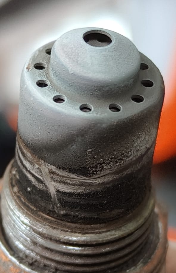

The O2 sensor also had the same whitish compound seen on the park plug last time.
Had it been oil-burning, this would have been black and wet.
Last year, when I cleaned the O2 sensor of my car randomly, it was also the same white color, Check here.
Spark plug after cleaning.
This did not help, and the check engine light kept coming back. At this point, I was sure the O2 sensor needed replacing.

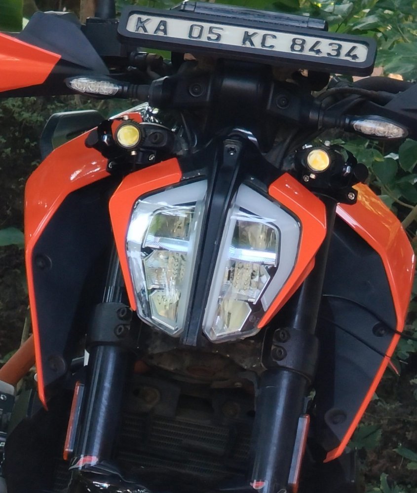

At about the same time, I also got the second replacement of HJG mini fog lights from Sarkkart. This time, they did not ask for a replacement and sent me a new single-piece fog light. Since today was the Christmas Holiday, I spent the whole day getting it fitted on the bike. I got some custom wiring done instead of purchasing a wiring kit since I wanted to get the power switch from the bike's accessory port, which powered on only when the key was on.
Here are some photos of the bike with fog lights installed using the fork clamps from HJG LEU.
My primary goal was to somehow incorporate the fog light with the design of the bike so that it doesn't look odd or stand out.
The final alignment is not yet done.

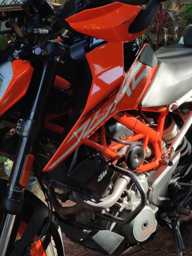

The roots windtone horns I fitted in the bike were giving me occasional troubles due to water entering them. A recent wash made it worse and one of the horns stopped sounding. I tried removing it and shaking the water off but it went in vein.
I finally decided to change the horns and were looking for a replacement, but then it struck me that I had a pair of OEM Maruti Suzuki dualtone horns lying useless at home which were removed from my Ignis(after installing roots windtone in it too).
I installed one of them in the stock horn position where it's a tight fit and second one in the clamp which I had earlier installed on the crash guard.
It sounds so much better and satisfying with the new setup.
The biggest advantage of this setup is that this is a sealed water proof unit and I don't have to worry again about water entering it.
I painted the second one fully black to give it a stealth look and not to stand out.

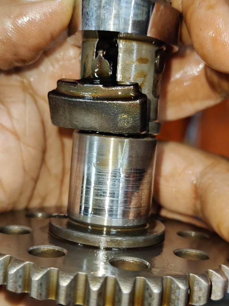

Off late, the bike started making the 'KTM tick' but only when the engine is at operating temperature. If at all it was the valve shims, the sound would have reduced when it's hot. So this was either the tensioner, guide or timing chain. Since the tensioner is a ticking time bomb in 390s, I replaced it.
It could have been done by loosing the throttle body and twisting it. But then I decided to remove the throttle body and airbox since both of them have never been cleaned before.
There seem to be valve stem oil seal leak as there were burnt deposits on intake valves. An engine top end overhaul is due along with the timing chain.
There were no differences length wise. And the tensioner was not the one causing the sound as the issue was not resolved.
Throttle body cleaned.
It took quite some time to take off everything, clean and then to put everything back together. But sadly the issue was not resolved and the slight ticking sound came back once the engine was hot.
After a few days the bike suddenly stopped while on my way to work. At first I thought it was one of the 3 wires which we have to plug in to the throttle body and it is one hell of a job to remove everything to fix it again.
But as crazy as it sounds I was delighted to see petrol gushing from the right side of the bike. The fuel filter had came off from one side of the fuel hose. I instantly pressed it back in and the bike was good to go. I realised that the fuel filter is around 10000km old and it is due to be replaced. So, I got it from Bajaj and replaced it.
It was interesting to find out that the filter is made by Sogefi, which is an Italian filter company. But it's made in their Indian plant.
Now back to the ticking sound, I am planning to get the timing chain replaced with a full head overhaul soon.

Since the owner was not available, the mechanics attended to this. On hearing the sound, they said that it is not related to the valve clearance and the injector causing the ticking sound. They were also against replacing the injector.
Since I traveled 120 km one way, I asked them to do the valve clearance check and timing chain replacement as they said it could be done without removing the engine and completed the same day.
Wear on the exhaust side finger from the decompressor.
One oil jet looked like it was clogged but was able to blow pressurized air.
The new timing chain is on top compared to the old one at the bottom, Although there is not much stretching in the old chain, the old chain had some hard links and it took some effort to straighten it. The old chain did its duty for 33500km.
