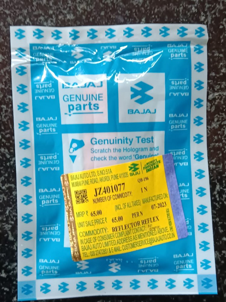

Added fork reflectors.
I always wanted to add them since it has been a norm in international models for so long.
Part JZ401077 (Pulsar N160)

Double-sided tape pre-applied.
Result

Where'd you get them? Dumb dealers here were unable to provide one despite multiple queries.
I got this from a Bajaj Service Center's Spare Parts outlet.
Excellent experience so far. Even if they don't have a part in stock, they will get it the next day from the main godown.
Despite being a small showroom and service center, they have 2 dedicated employees for spare parts.
Meanwhile, the local Yamaha is like a makeshift showroom. The billing lady there also deals with the spare parts. And the default answer is always 'no' for all parts.
Recently, I had to replace the front wheel bearings of my FZ. I got it from the Bajaj service center without any fuss.

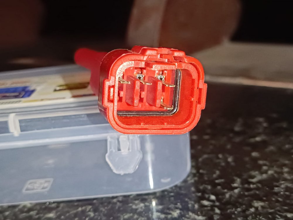

I finally ordered an OBD cable that directly fits to the KTM obd port as I got tired of connecting individual wires manually all the time.
The cable itself was selling for ₹500-1K on Amazon and Flipkart. But, I got a deal on Flipkart for ₹500 with both cable and a ELM 327 knock off adaptor.
The cable I received at first was not working as 1/4 wire didn't have continuity. Requested a replacement and finally got a working one.
Life is so much easier now, especially when you need to use the OBD in different bikes.
The OBD adapter can be used to read and clear error codes as well as to log the sensor values of the bike to understand the health of the bike.

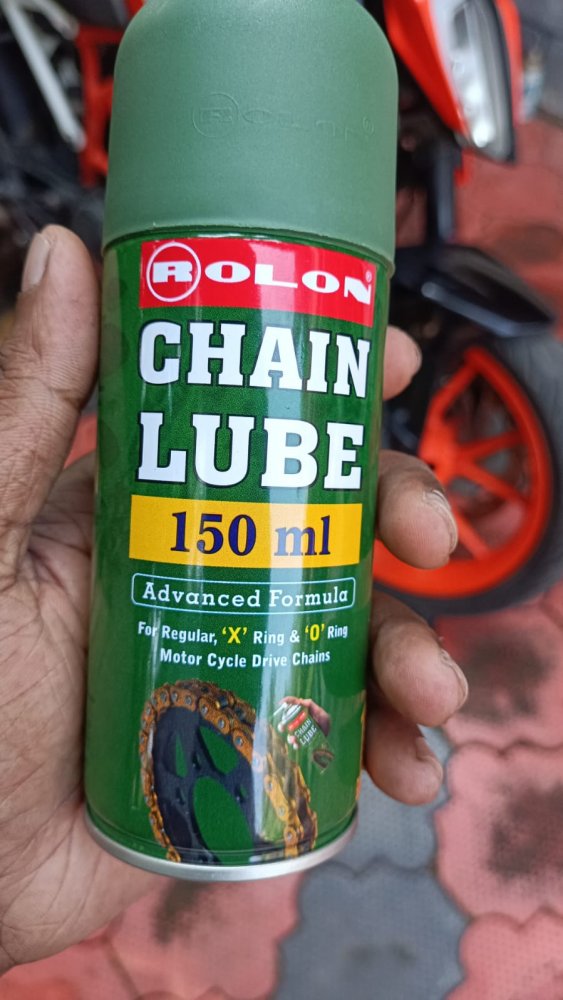

I am so done with using gear oil for chain lubrication. I use 140W gear oil, the thickest I could find.
For the 390, it never stays on the chain if you ride it like it's meant to be ridden. Plus, the rear wheel looks like crap from all the dust build-up on scattered oil.
The dirt was so thick and no amount of soap could remove it, I ended up losing some paint on the rear wheel while trying to scrub it with scotch brite. Never use it to clean anything else other than metal surfaces!
Finally, I poured petrol over it and managed to clean it somehow.
I was using Tribicor chain lube before and it looks like a paste.
I will only use chain lube from now on as the extended chain life (if any?) is not at all worth the trouble of re-lubing and cleaning the rear wheel frequently!

Chain lubes are handy and easy to use, but won't extend the life. I got almost twice the life with thicker oil compared to chain lubes. Used almost all brands of chain lubes except the newer brands and 90 and 140 gear oils. I use thicker than 140 grade, which is hard to remove from hand when dirty, not to mention the wheels. But using diesel or kerosene, it comes off easily. The trick is to apply between each link on either side and leave it overnight and lasts easily for 700-1000 km without relube. Won't get washed off in rain like chain sprays. Wiping off the excess would leave less grim on wheels. Can be easily cleaned with a spray soak of diesel and pressure wash. Just replaced FZ's chain this Sunday, which ran 40k km on just the oil. Petrol is not the right solvent. Vim liquid will also work, but have to rub a couple of times with a sponge

Funny, my experience was total opposite. Using Motul C2 made the chain super gunky and accumulated lot of sand and crap. With gear oil, there is a very light coat of dust on the chain at max. I'm using savsol? 140W. cheapest of the 140W at 120rs for 500ml
I put 2 liiight strings of oil, one on each side from the inside then level it all using a clean dry toothbrush. I then level the outsides and wipe off excess with a cotton waste. I barely get any sling, even if I get some, it washes away easily with regular car shampoo without any rubbing. Which is total opposite if I use Motul C2.

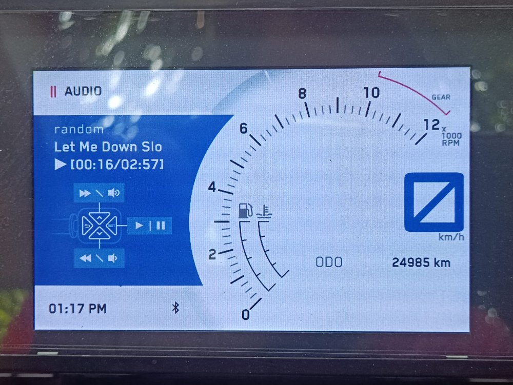

The bike came with a TFT which was able to control music playback in phone and display incoming call details to answer or reject calls.
A few years ago, KTM removed the My ride app which was used for connecting to the TFT from app store which made this a useless piece of hardware, The phone never pairs with the TFT if we try to pair like a normal bluetooth device.
Today, I tried eDubugger app which used a console tool for Bluetooth devices. It can send and receive commands to bluetooth devices.
I was able to connect and pair with the TFT.
Now, whenever the bike is turned on, it will automatically connect to the phone and display incoming calls and music details. But contact names are not shown, instead some random characters are shown.
It is possible to tinker with this and find some commands to send to the TFT which displays the notification pop up and then use that to show the navigation alerts from Google maps while using Google maps for navigation. A companion app has to be made for Android to make this possible. I really wanted to experiment but it needs the TFT to be powered on for a long time and it's only possible if I remove it from the bike and supply it with the required power.
For now, I can control music (which I don't really use) and most importantly I can disconnect calls while I am riding without touching the phone. Oh, and the TFT also shows the phone's battery level.
