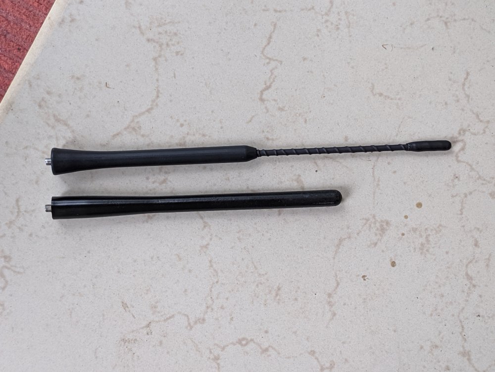

The hack job looks stock, won't differentiate easily.
Check whether other OEMs would fit. Bought universal one for Polo. Works okay, better than no antenna, but not as good as stock.
Got a universal one from Amazon for Rs.300 which turned out to be useless. There was 0 reception.
It was a relevation when I found out that the antenna thread of our Ignis is same as the Sail. However, the rubber covering had to be cut for it to fit. Got one from Suzuki Spare parts store for Rs. 230.
It is the same antenna used in Ignis, Swift, S Cross, and Baleno.
Suzuki Antenna in the bottom with the rubber cut off from the end.
The newly bought antenna was installed in the Ignis and the one from Ignis was cut and installed in the Sail.
The radio is so clear now even in an enclosed parking spot with metal roofing. I have never heard the radio in this car with so much clarity even with the OEM antenna. It basically feels like streaming from the internet.
Therefore, if anyone is looking to improve the radio reception of their Chevrolet Sail or any other car (if the thread is the same), get a Maruti Suzuki Antenna for Rs. 230!

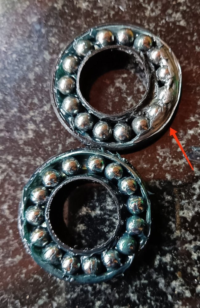

Old mounting bush and bearing. The bearing is made in Germany.
It was a huge mistake to use the Technix Rs. 150 bearing that came with the kit during the overhaul. The left side bearing failed within 2000 km and it's making 'tak tak' sound while turning the steering at a standstill.
As it turned out, the OEM Made in Germany bearing was a Febi Bilstein/SACHS one shared with Audi TT, VW Polo, Chevrolet Spark, etc. The OEM part costs about 700+ So, everyone, don't use cheap Technix bearings as they'll fail so quickly.
The old one was intact and I had kept them after the overhaul. Planning to install it back in the shock.

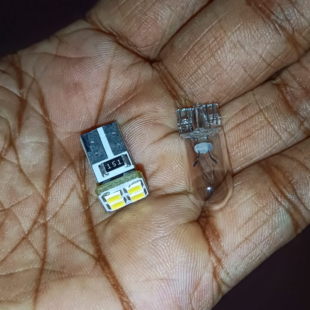

Replaced the high mount brake light bulbs(4 nos) with LED.
The LED used was Super 2828 LED Parking Light T10 LED which costs Rs.84 a pair.
It is made in India by a Coimbatore-based company and lasts really long. I installed one in my FZ in 2018 and it's still good after 4 years.
This is a better choice than other Chinese LEDs with fancy heatshields and more LEDs that blow within a year.
Previously, it was 5W X 4 = 20W.
Now, 1.2W x 4 = 4.8 W
15W power saved.

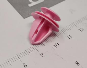

Also changed the wiper blades of the car with after-market wiper blades from Spark Minda, ordered through boodmo.
22 inch - Rs 213
15 inch - Rs 147
Also got the clip for the door from boodmo. The clip of Tata Harrier is compatible and costs half of the OEM.

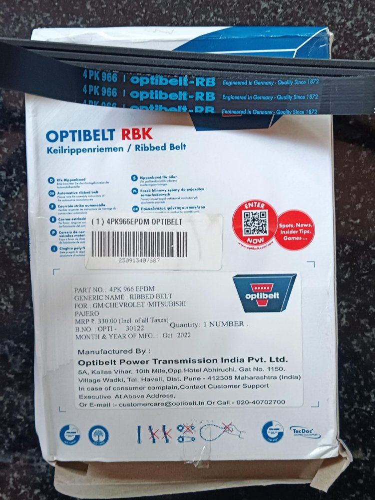

The car started making a tak tak sound recently. I found out that this sound was coming from the AC belt.
The belt was already on its way out since it was making squealing sounds in the rain.
Sail uses a 2 belt setup.
I decided to change both belts even though only one was damaged since both were of the same make and age.
Part Numbers
4PK966 (big belt)
4PK866 (small belt for AC compressor)
4PK966 was easy to source but the 4PK866 one was not available in boodmo or in local spare parts stores.
I was able to get 4PK865 from boodmo which was a replacement part. It was 1mm smaller. The number in the part number represents the length in mm.
+-3mm is allowed in belts.
Parts Cost: 343 + 302 = 645.
The 4PK865 I ordered on boodmo was Gates brand. But I was given a Continental belt which was 2 years old.
Since I did not want to bother with returning it and ordering again, I went ahead with this.
Beware of this while ordering from boodmo. Before checkout, there is a checkbox to make sure that you will only be sent the exact part you ordered.
I got this installed from a trusty FNG. They charged me Rs. 300.
Total Cost: 945
The car now idles smooth like how it was from the factory.
