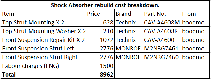

Thankfully, boodmo had several options listed from major brands like Gabriel, Motherson, and Technix. All of them were available at 1/4 the price of the OEM part as well. I went with Technix since they had a better catalog that showed the actual compatible parts and their part numbers.
I ordered CAV-A4600, CAV-A4608M, and CAV-A4608R 2 each for both sides.
Mounting Bush.
Bump stop, bearing, and dust boot.
Mounting top retainer.
Replaced all this from an FNG (Friendly Neighbourhood Garage) and all of a sudden the car was undrivable as it was bouncing all over the place. Front shocks were found to be hard during the disassembly of the struct.

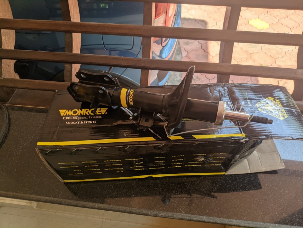

The only solution left was to replace both shocks. Boodmo came again for help as they had shocks in stock. Interestingly they had Monroe shocks for Sail at the same price as the OEM Chevrolet shocks. Since the OEM shocks gave away in 30000 KM, I decided to go with Monroe.
Shocks came from different sellers and one of them was poorly packed, due to which one of its clamps was bent with some impact during transport. I returned that to boodmo and placed another order for the same part since boodmo doesn't have a replacement option. Currently, I am waiting for the shock to start the overhaul.

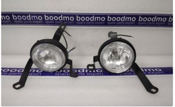

The car was fitted with a generic fog lamp from an accessory shop which broke after a few years of usage. I never bothered to touch it since the OEM fog lamps cost some 7.5K a pair and it did;t justify the price.
But then, I came across an aftermarket fog lamp in boodmo made by a company called Globex which had the right clamps to directly screw it onto the bumper. Ordered it without thinking twice.It was just Rs.800 per pair and so I wasn't expecting a lot. It is a basic unit.
Replaced the cheap unbranded bulbs which came with it with Bosch H3 45W bulbs. I tried a lot to get 35W H3 bulbs to reduce the heat and avoid getting it broken again, but they are only made by Hella and are not available in India.
Removing the bumper of the Chevrolet Sail is one of the hardest jobs in this car. There are so many screws and clips in weird locations. Since the wiring was already laid for the previous fog lamp, I decided to install the new fog lamp by removing the front wheels and wheel well.
Fog lamp view from inside after installation. The wiring for this is done using a relay and a fuse and the switch is placed under the steering rack. The car also has a Roots Wind tone Skoda type horn installed with similar relay and fuse wiring.
The end result.
The throw is nowhere near an OEM fitment as there is no level adjustment in this. Acts more like cornering lights than fog lamps!

It was way cheaper than going with OEM parts. Surprisingly, the struct was not the costly OEM part. It was all tiny bits of bushes and bearings that cost a lot more.
Saved Rs. 3250 in parts.
I have been told that Monroe shocks are not the best out there. Decided to take the risk since the OEM shock gave up so quickly.
Monroe shocks have been given a 1-year warranty from the date of manufacturing. One of my new shocks is a month old while one was 2 years old.
Monroe India manufacturer Tenco extended the warranty for another 8 months after I contacted them.

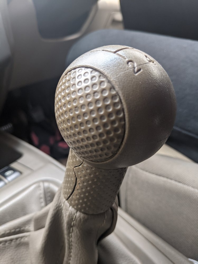

Remove and check once in a while. Used to use the same cover before buying new knob. There was gel like formation.
Thanks for the tip. Yes it looks like some cheap rubber.
