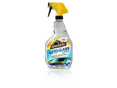

5. Any good Automotive Glass Cleaner i used Armor ALL :

7. Once done spray the glass cleaner and wipe clean again.
