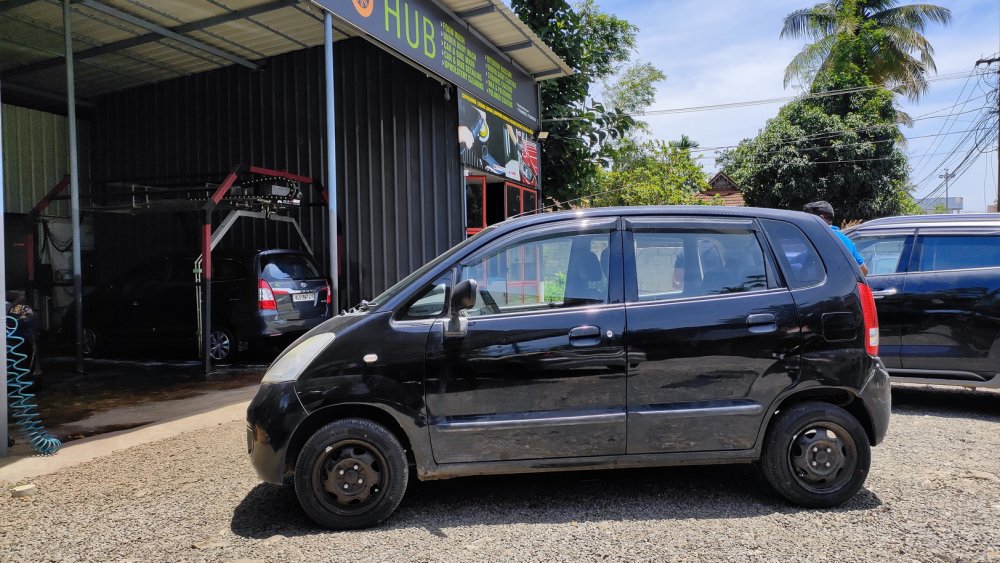

Went straight to car wash for a long-pending underbody wash. Quality of wash wasn't great, with lack of attention to detail. Dirt remained at many places when dry. But they (cousin and BIL) made it a habit to visit the car wash monthly (a different, better car wash).
