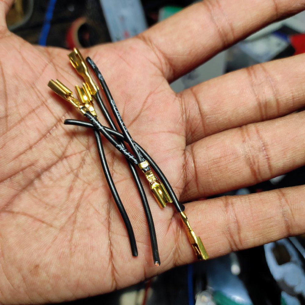

Swapped with original working Anupam to check everything was in order before cutting wires.
2.8-mm female spade connectors.
Crimped.

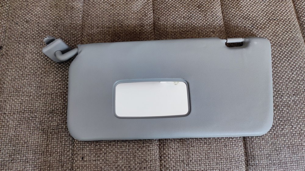

April 2022 - VXi Sun Visor
The passenger-side sun visor was broken and would fall off if messed with. Spotted VXi visor with mirror on Boodmo and ordered along with the foglamp switch.
Left Sunvisor Assembly (Gray) - 84802M59K40-6GS - ₹ 225.00 + ₹ 90.00

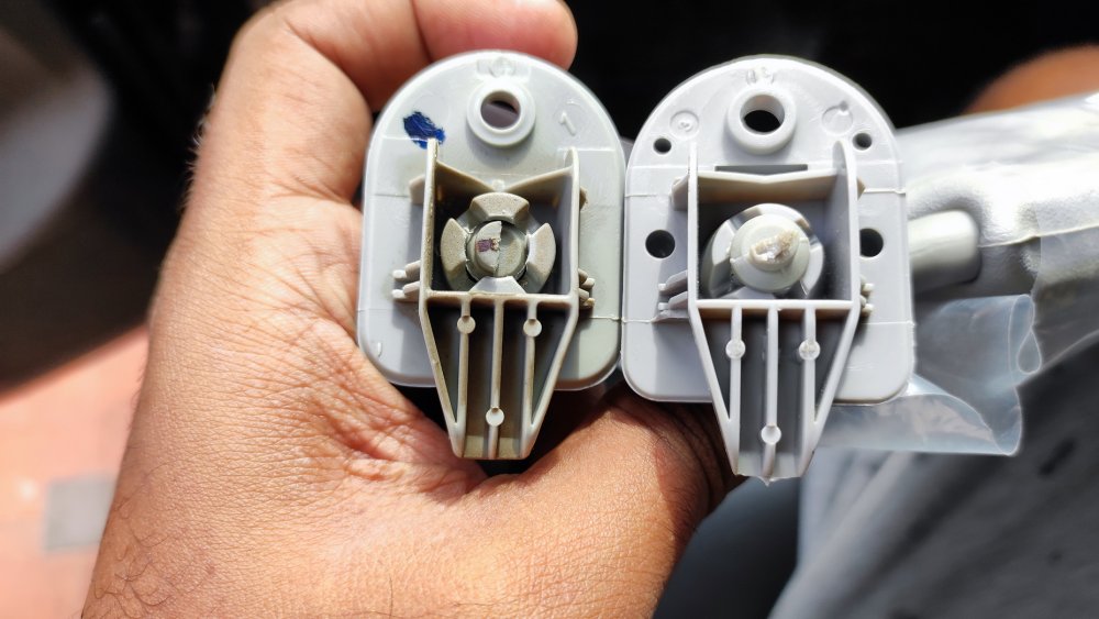

Old broken one.

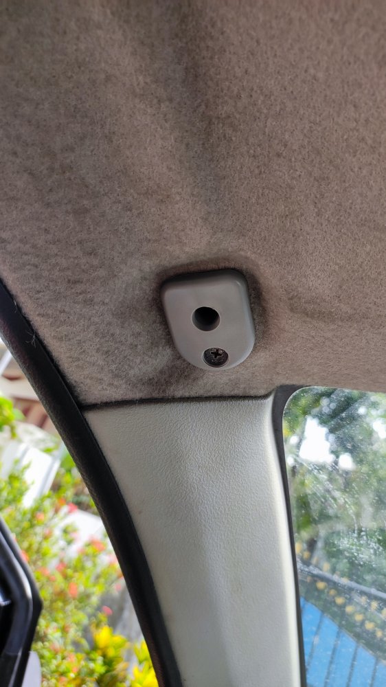

The pivot got worn and gave way.
Old vs new. Old one got swollen, typical for a 15-year-old Maruti.
Installed.
Seen visor from new Baleno with similar dimensions with proper framed mirror with cover.
