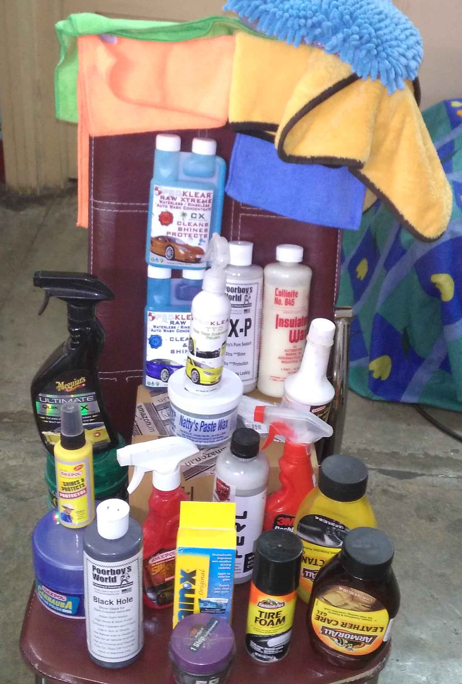

Hi friends, below are the products in my armor and more are going to add like GYEON Q2M BATHE+, KLASSE HIGH GLOSS SEALANT GLAZE, CarPro HydrO2 , couple of mf cloths, mf pads and foam pads. thanks and regards for your great cooperation and help.

Saarji that's an awesome collection, now just tell me how many soaps, shampoos and towels you use for your personal cleaning and detailing? :stupid:
That's an awesome collection and if I am not wrong then you have a stock for at least 2-3 years in your inventory.
