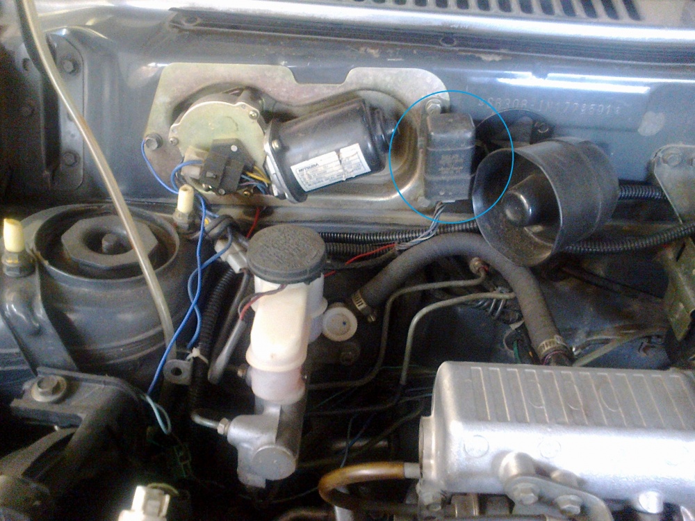

Can anyone please post a picture of any wiper relay, just to get an idea how it looks, so that It can be a DIY for me.

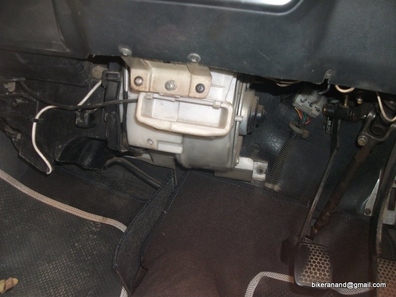

Yes the AC is working fine, but the problem is if I use the AC for a long time with blower in full speed. There is some leakage (not sure if its water/ coolant) in the foot well area of the front passenger seat. Need to get that thing fixed too.

The leakage I was talking about (when AC is on) is coming from the left black box I guess.

Wiper relay will be placed next to the wiper motor (inside bonnet)

The water from the left side is the A/C drain pipe, not to worry .
Just pull the rubber hose and let it out from the cabin..
Here the black box is the A\C condenser and the blower unit.

Is the condition of the foam & bottom of seat alright? I have never seen any other cars foam, so am a bit worried. The AC works fine, cabin temperature drop takes about 3 - 4mins, with 2people in the car. I thought the leakage was some big issue with AC, now feeling better. In the beginning every small issue scares, but then First Used car experience is a kind of learning.
