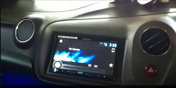

DESIGN & ADOPTERS:
It is a very important factor despite of its best quality , it should seamlessly integrate with the dash board panel of the car. Unnecessary protrusion will spoil everything. Though ‘2 DIN’ is a universal specification, the set should merge with the OE panel design or we should be able get a panel to suit our dash board. (1 DIN = a 7 inch wide, 2 inch tall unit)
It is also important to check the availability of suitable 2DIN Connectors / Socket adopters to OE wiring harness, to avoid cutting of wires.
I understand from sites over internet, one of the latest & best model like Pioneer AVH-X5690BT don’t require a finisher panel, go well with OE dash as shown here, merge perfectly in Honda Amaze; hope, same for ANHC.

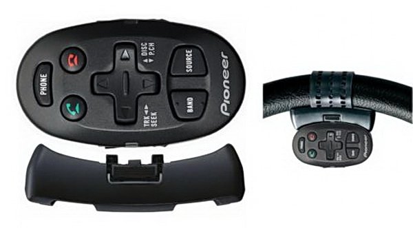

REMOTE & STEERING WHEEL CONTROL
For me, this is a most important function & requirement. I did not get either the audio steering control or an IR remote control with my OE HU for an expensive car like ANHC EMT version.
After market set like CASKA has only wired control to connect OE steering control harness, but no IR remote.
It is better to have both – The Steering control while self-driving and IR Remote for our back sitters. But not all the aftermarket HU has both.
If you have OE steering control, check the compatibility or can it be made with adopters. We may require to buy external adapter of "Connects2" (cost around 3 K) if Pioneer SWC wire doesn't work in our car.
For a car like me, without remote control, IR remote is a must. I can use two remotes with IR - one aftermarket steering remote like Pioneer CD-SR110 and another credit card type which should come with HU, for co passengers. The aftermarket steering remote needs periodical replacement of battery.
Pioneer CD-SR110 :Aside from enabling control of your DVD/CD player, this steering wheel remote also enables you to control Bluetooth functionality.
