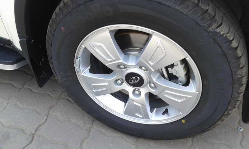

The alloys shown in the pic is not the OE alloy of the XUV. This one is a accessory sold by Mahindra.
There are NO issues with the OE alloys which comes in the W8 version of the XUV (top end). Those who are option for the W6/W4 and then buying these "speed alloys" from the dealer should be careful as there have been about 3-5 reports of them cracking and breaking.
I think Mahindra should do a thorough investigation in this matter since these "speed alloys" are being sold by them as an accessory.

Looks like there are a ‘couple’ of incidents ‘reported’ of the ‘ speed alloy’ that are offered as an ‘accessory’ at the dealerships as in the pictures in the OP. Definitely a cause of concern and I am sure Mahindra is already investigating on this.
The thing is that alloys made out of aluminium are ‘brittle’ by nature and hence the design becomes a crucial element. Having said that, in order to claim ‘in public’ any defect at the manufacture level, one needs to have adequate ‘evidences’ and we only have a couple of them, out of which one can’t make any generalization on the cause at the moment. But, even if it’s one odd case, it needs to be investigated in order to trace the root cause and until then those ‘speed alloys’ shouldn’t be sold at the dealerships, IMHO.
I don’t press any panic button on the “OE” alloy as the cause of such cracks are many, the heavy impacts from the ‘ pot-hols’ on Indian roads being the most significant for such an odd case IMO. You may be a careful driver but those hidden huge pot-holes and debris can’t be avoided all the time and the impact on the rims when a 2 tonner crashes into one of them at a good speed shouldn’t be understated.
They should have had those OE alloys on those test mules at the development stage but probably not those ‘speed alloys’, hence the need for a thorough investigation.

Now, to further substantiate my above statement, I would like put on record here in the benefit of all existing XUV owners and the prospective buyers who intend to buy accessories from OEM, I have today itself met with Executives of one of the biggest Dealer of Mahindra in Delhi NCR to provide this feedback to them. Here are some pics and details which I would like to share:
The Genuine Alloys of XUV 500
Cost: INR 65K-70K​
The Design of Alloys sold as Accessory by OEM Dealers
Cost: INR 43,500 under exchange for 5 Alloys (Flower Design) for W4 and W6 models.
Here is the proof of cost from the Dealer itself for accessory alloys
Now, The unsuspecting customer buys these alloys only to accentuate the looks of the car and with the trust of the brand and not risk his/her life. I spoke to the executive about the same and here is what the conversation was:
