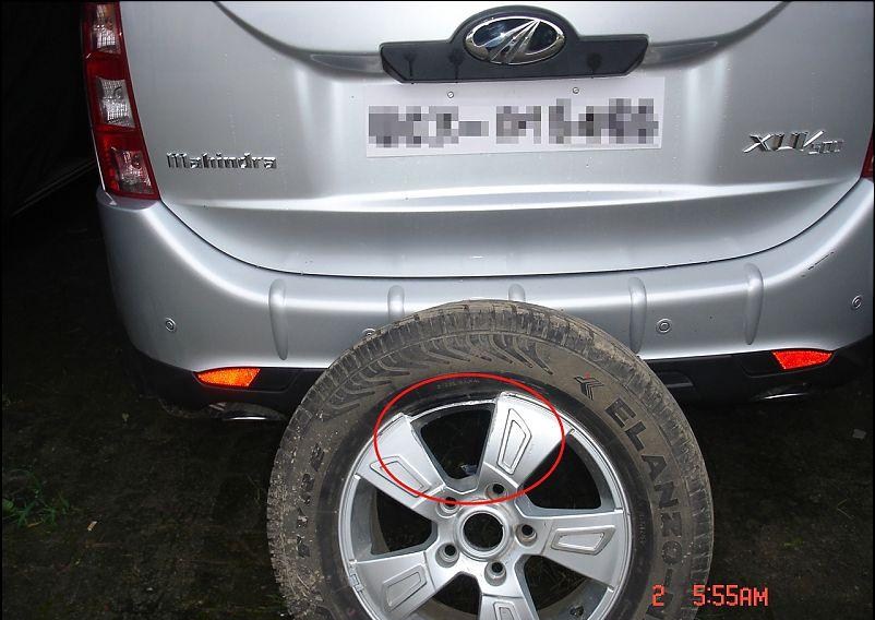

Friends,
Happened to read on FB page of a automotive forum that the alloy wheel of XUV 500 are not at all reliable. The pics posted there showed how the alloy rim broke from center but god willingly nothing untoward happened and owner was safe as the SUV was driven at a low speed about 30 km/h.
Question is, if one of the most significant part of the car i.e wheels are not in best of quality then what's the credibility of such a big brand selling such an expensive SUV? In this incident the car was at low speed but what if this kind of horror would have happened on some highway at a high speed like 80-90 km/h?
Please, humbly requesting all owners of XUV 500 to be alert of this issue and take precautions so that such an untoward thing should not happen to your vehicle!
Please share your opinion on this horrifying incident!

Re: Mahindra XUV500 Alloys Break: Quality Compromise?
INCOMPLETE INFORMATION ALERT!
The alloys shown in the pic is not the OE alloy of the XUV. This one is a accessory sold by Mahindra.
There are NO issues with the OE alloys which comes in the W8 version of the XUV (top end). Those who are option for the W6/W4 and then buying these "speed alloys" from the dealer should be careful as there have been about 3-5 reports of them cracking and breaking.
I think Mahindra should do a thorough investigation in this matter since these "speed alloys" are being sold by them as an accessory.
Looks like there are a ‘couple’ of incidents ‘reported’ of the ‘ speed alloy’ that are offered as an ‘accessory’ at the dealerships as in the pictures in the OP. Definitely a cause of concern and I am sure Mahindra is already investigating on this.
The thing is that alloys made out of aluminium are ‘brittle’ by nature and hence the design becomes a crucial element. Having said that, in order to claim ‘in public’ any defect at the manufacture level, one needs to have adequate ‘evidences’ and we only have a couple of them, out of which one can’t make any generalization on the cause at the moment. But, even if it’s one odd case, it needs to be investigated in order to trace the root cause and until then those ‘speed alloys’ shouldn’t be sold at the dealerships, IMHO.
I don’t press any panic button on the “OE” alloy as the cause of such cracks are many, the heavy impacts from the ‘ pot-hols’ on Indian roads being the most significant for such an odd case IMO. You may be a careful driver but those hidden huge pot-holes and debris can’t be avoided all the time and the impact on the rims when a 2 tonner crashes into one of them at a good speed shouldn’t be understated.
They should have had those OE alloys on those test mules at the development stage but probably not those ‘speed alloys’, hence the need for a thorough investigation.
There was an incident of OE alloy cracking.
Source: from another forum
AGAIN INCOMPLETE INFORMATION ALERT!
That was just one incident out of the lakhs of XUVs running on the road and hence we cannot call that a manufacturing defect.
The person who posted this on the forum clearly mentioned - "driver was driving on a narrow and rough road (usual Indian road). Got the left wheels off the road and applied brakes... heard a sound."
It was mostly a case of the wheel hitting on to a kerb or something else off the road.
Mahindra is offering them as an accessory so obviously the person will contact the showroom. Even if the car went into a huge pothole, the tyre will burst and i have always seen alloys outer rim to be damaged (bent or cracked)and not from where the bolts are.
If you are talking about the person with the OE wheel (post # 3), he did contact the showroom and Mahindra replaced the wheel under warranty.
Again, Mahindra is said to be very generous with warranty claims (for XUV and Rexton customers). Point is, there are so many XUVs on the road with these wheels, if there was any problem with the OE wheels of the W8, it would have been clearly highlighted by now.
+100 Raj,I completely agree with what you said.
Guys rather then jumping on the conclusion of the quality from Mahindra look at the issue that was reported.Most of those cases were from the accessory alloys that were purchased on the lower trim and out of them 3 to 4 cases got this complains.
There might be possibility of one of the shipments of alloys, that batch had some issue which i am sure Mahindra would be looking into the matter surely.
Friends,
The issue of Alloys breaking is a serious one as you all agree. Now, immaterial is the fact whether they are sold as OEM fitment or whether they are sold as a accessory by OEM dealer, point is, how come Mahindra shared it's brand name with a product whose quality even for 1 shipment or lot has been sub-standard? Why was there over-shoot of protocol of quality inspection by Mahindra even if it is for 1 piece of alloy or 1 particular shipment? Do You think Mahindra won't be knowing of the shortfall of this particular design of alloys? When a common buyer associates with a brand then he expects certain amount of trust and assurance from the brand. It is not about the lakhs of XUV500 being driven on road, it is about the life of those few people which were at stake when a accident like this happened. It needs only a couple of fed-up customers to ruin the image of a particular brand no matter Indian or International.
Now, to further substantiate my above statement, I would like put on record here in the benefit of all existing XUV owners and the prospective buyers who intend to buy accessories from OEM, I have today itself met with Executives of one of the biggest Dealer of Mahindra in Delhi NCR to provide this feedback to them. Here are some pics and details which I would like to share:

What I mentioned was that the first post was "incomplete". It did not mention that the issue was with the "speed" alloys, which is an optional accessory. It just mentioned "XUV's alloys". Readers can easily mistake this for the OE alloys in the W8.
Rajeev, I am not an owner of XUV500, Still the issue is very much of serious concern for all of the automotive communities and owners. The point you are referring to could be right, however, the original source of this info does not mention word "Speed" on their FB.
Alloy wheels breaking off while the car is in motion - sounds disturbing!
More than a couple of XUV500 owners have already faced this issue! Potential XUV500 safety issue: Weak alloy wheels?
My XUV is just two and half months old and I've driven only 7200 kms. The alloy broke when the vehicle was running..I didn't hit anywhere...no accident nothing...
So probably, incomplete info as you said earlier, was not from our end but from the original source.
C'mon Akash, we are all automotive enthusiasts here. I believe you can easily identify stock alloys of XUV and these accessory ones.
Anyways, I wanted to clear up the facts from my side. So cheers!
