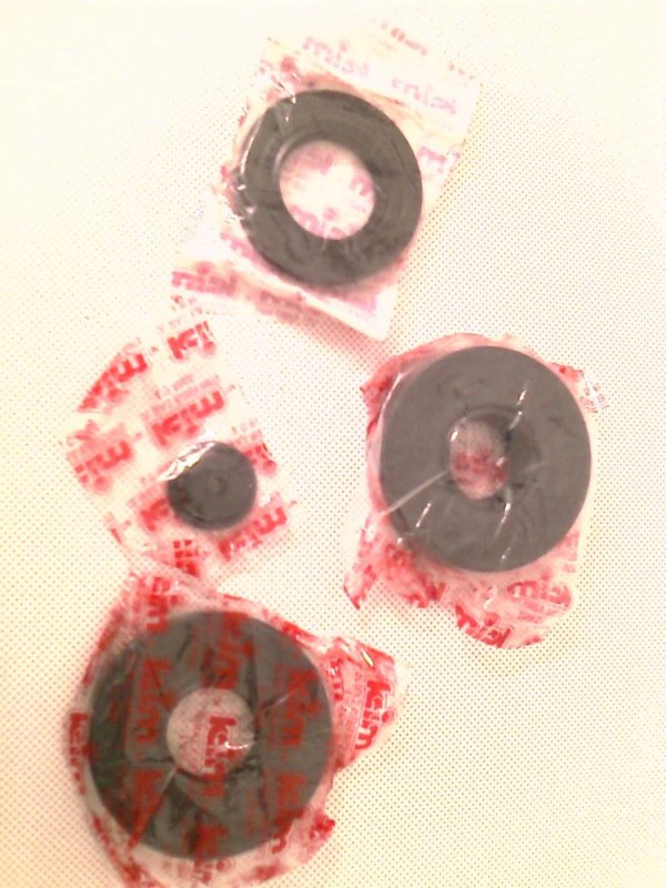

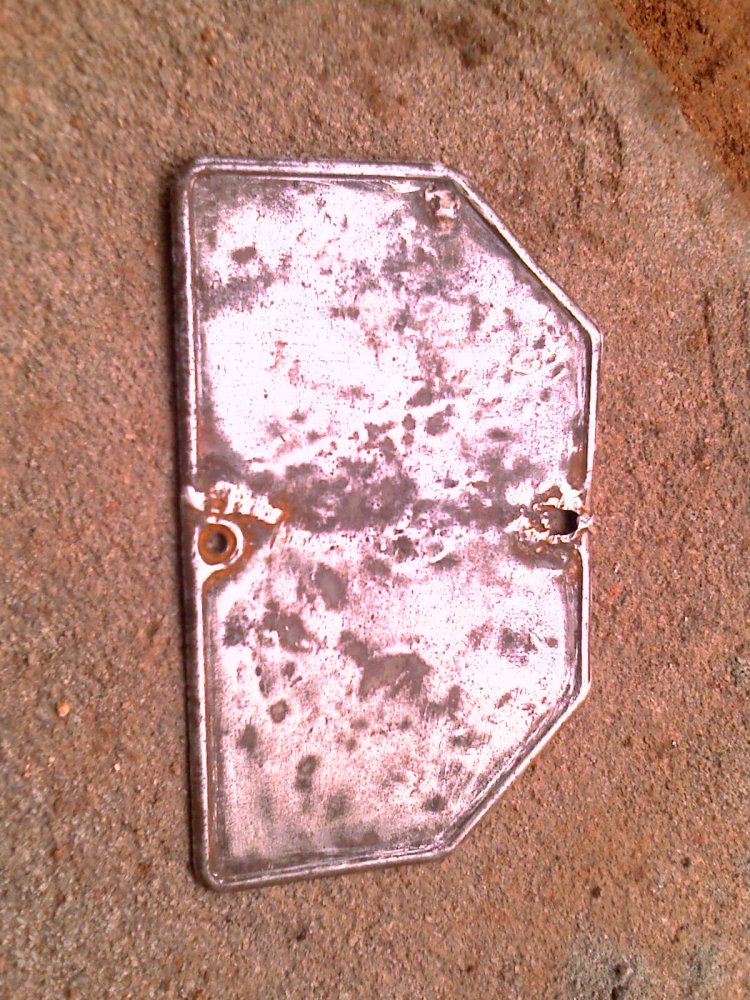

Parallel work on existing parts
  • · Electroplating parts
  • · Painting – Scorpio Black – Du Pont
  • · Seat fixing
  • · Shock absorber fixing

Nuremberg
parts pics
