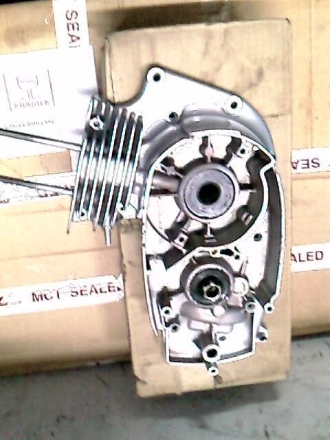

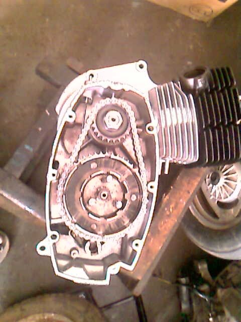

Yes [:)] So back to main part. Engine Problem . A big challenge is of course getting parts esp OEM items. [frustration]
First Challenge :-
  • Fourth gear Slipping – Must be due to gear rode shake. While fitting in crank case the rode was not seating properly. So crank case and gear rod need to be fixed
  • Speedometer – Yezdi speedometer cable is connected to engine. Pinion set was not available. Got one new set but didn’t hold much – It was made of plastic. Was in hunt for steel rod. Luckily got one.
  • New piston and cylinder seems fine for setting up . So not much worry over those.
  • Clutch Plate I have bought new since old is gone.
  • Magneto timing, Point system seems working fine so no work on it.

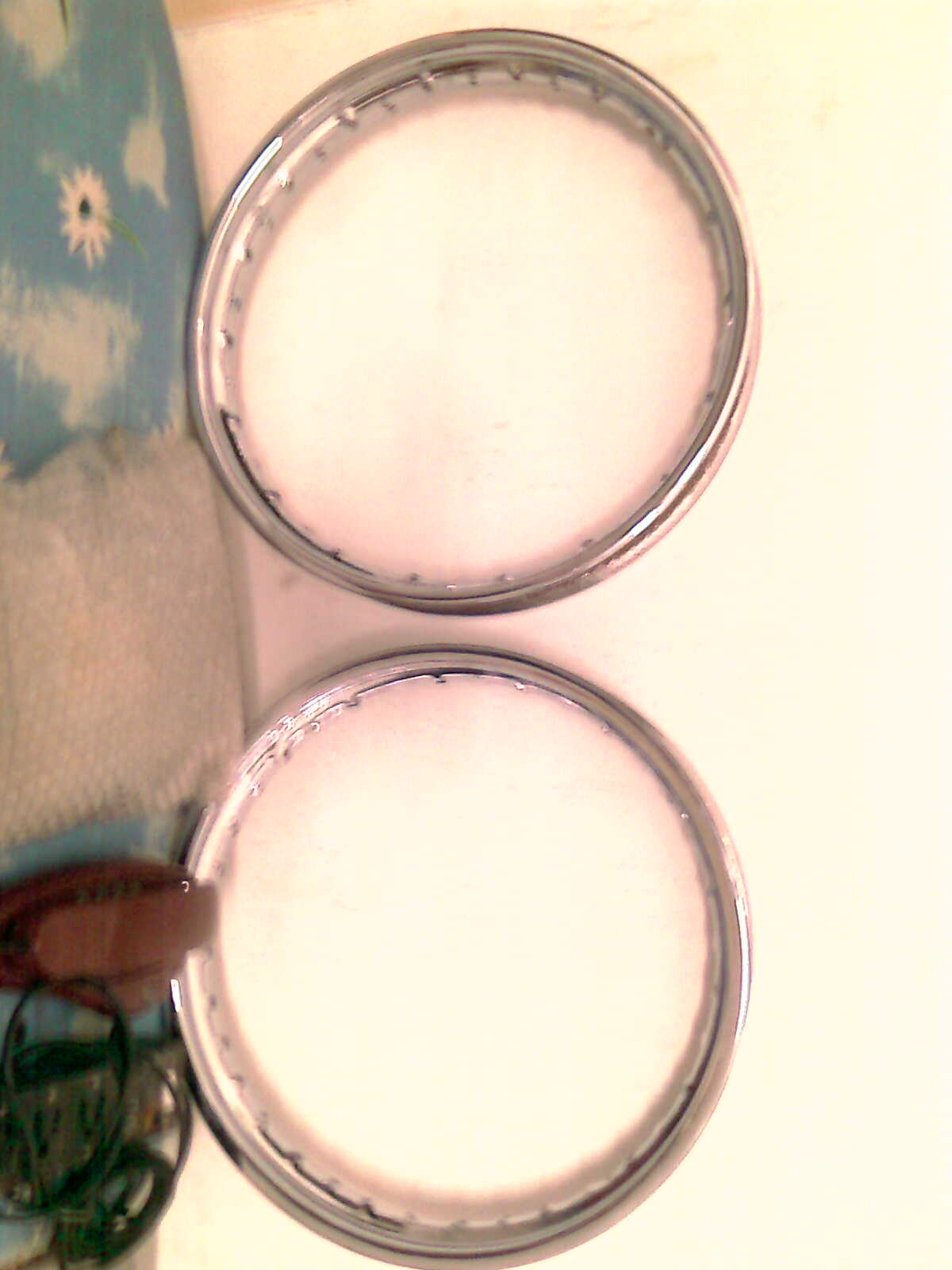

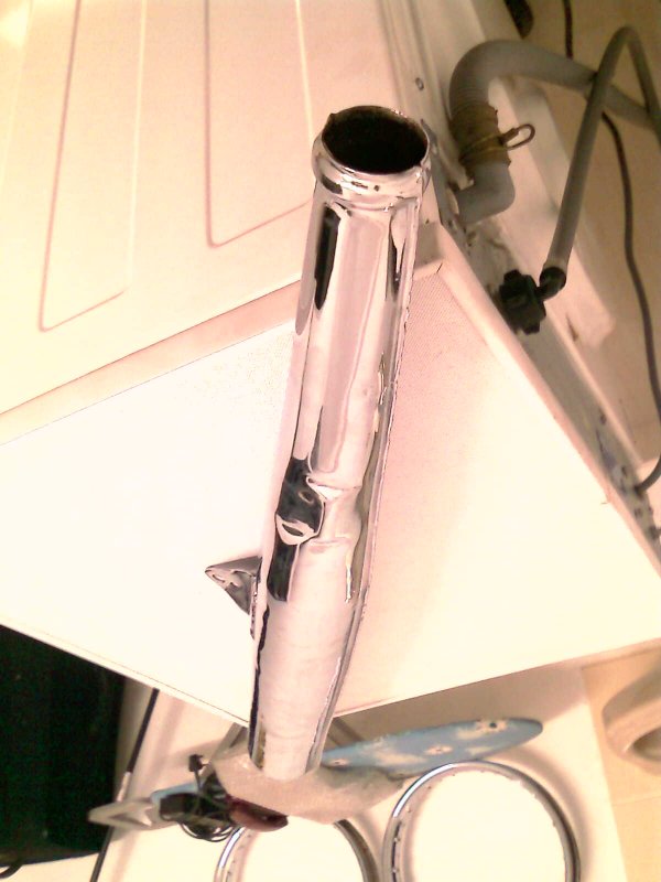

Plating cost me around 3k
Two silencer costing 600 each
Rest all coming filling the rest 1800 bucks.
