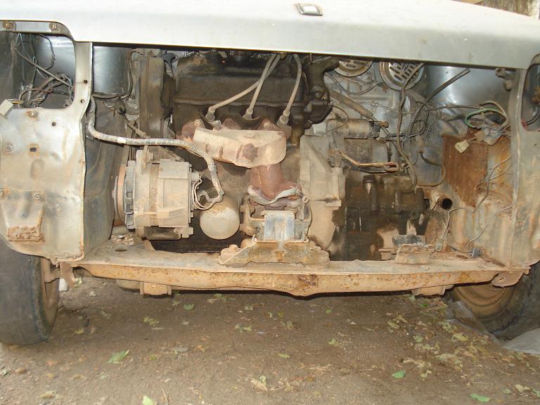

the engine bay.
here are few picture of engine bay.
engine will be removed in a day or two.
Lot of rust , lot of crack in chassis and apron panel
even a crack in apron panel.
cross member in front is rusted.
Literally there is no floor itself
All the rusted part need replacement ,which are available at cheaper price at maruti authorised store.
BUT
I am not going to buy them all .
Everything is gonna be welded to get strength.
this car is purely for city and for lending purpose.
Dad want to keep cost as minimum as possible.
and welding is not a big harm. it has same strength as new one except in look wise , which affect the resale , but that resale idea is not in our mind now.
