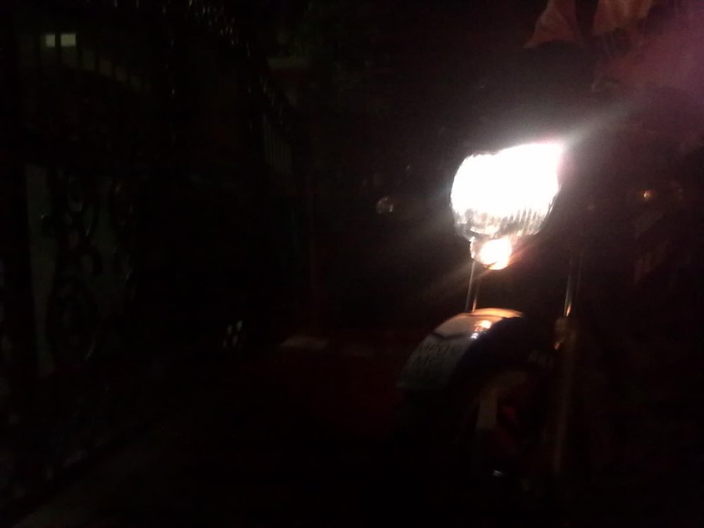

Yes, its a bit dark for a 35w bulb. light is passing through with a 6000k HID look to it as the shade is jet blue. the light is enough to alert oncoming traffic. it was just an experiment to see how the guy does his work. will get a lighter shade on this & also on the swift's headlamps. will post a pic of the vision at 9pm[cry]
Aug 15, 2010
113
Indore
Pics
The light is reduced but my cam is 2mp. in real life its enough for driving on a (Street) lightened road. anyways will get a lighter shade[cry]
