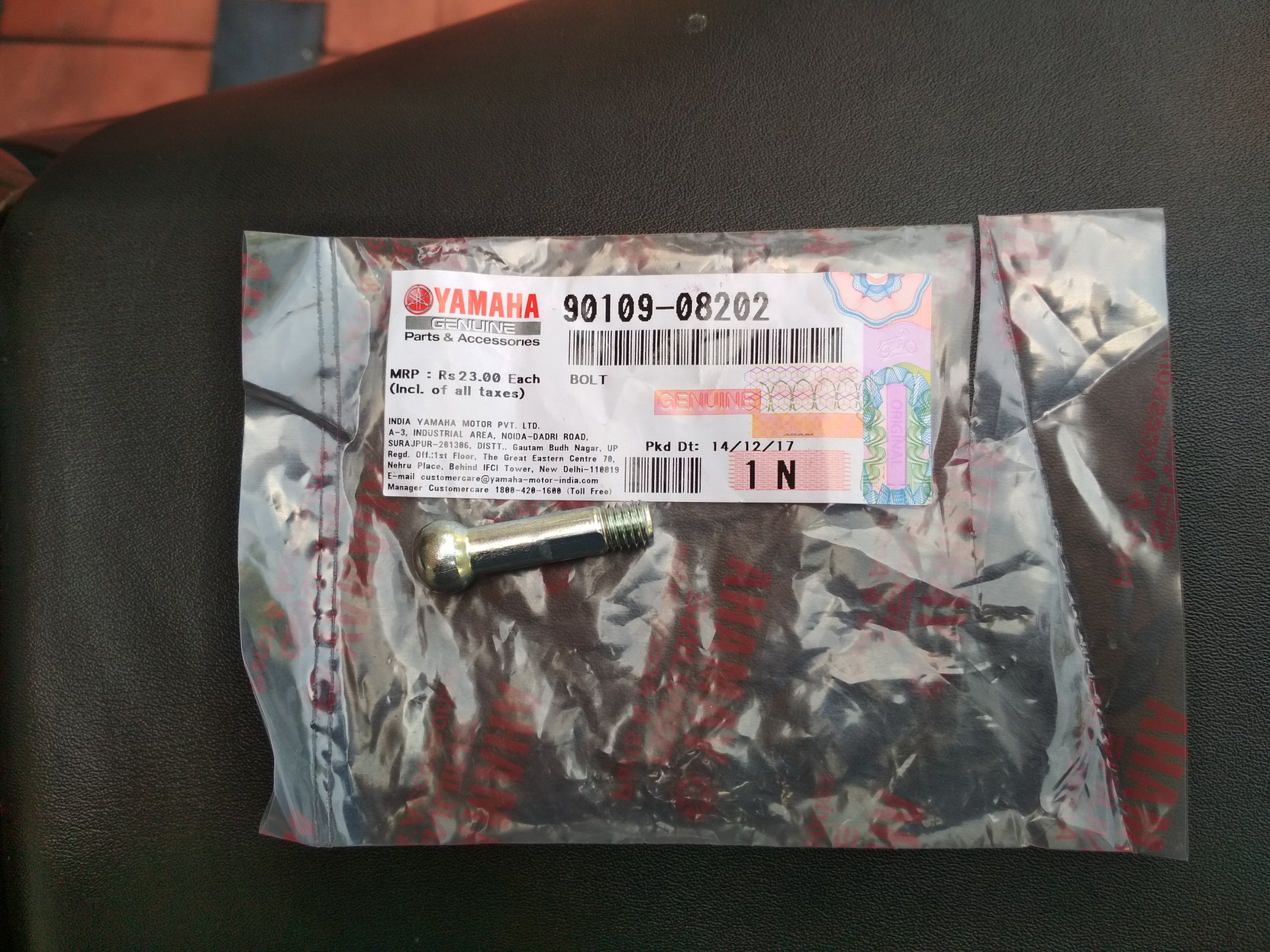

Lost in knee scrapping [evil]
Footrest Bolt - 901090820200 - ₹ 23.00

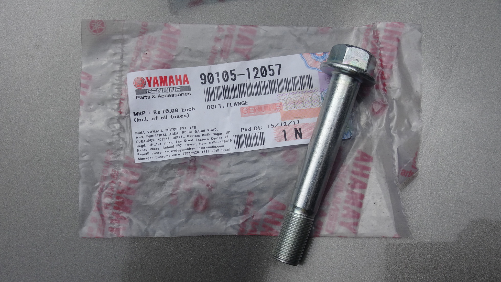

Monoshock was fully packed up. Change was inevitable. Bolt was stuck, so changed at Vinayaka Honda, a friendly neighborhood Honda garage. Total damage ₹ 3,071.00 parts + ₹ 450.00 labor.
Rear Shock Absorber Assembly 21C-F2210-00 ₹ 2,910.00
Yamaha OEM is Gabriel
U Nut - 95612-12100 - ₹ 55.00
Flange Bolt 90105-12057 ₹ 70.00

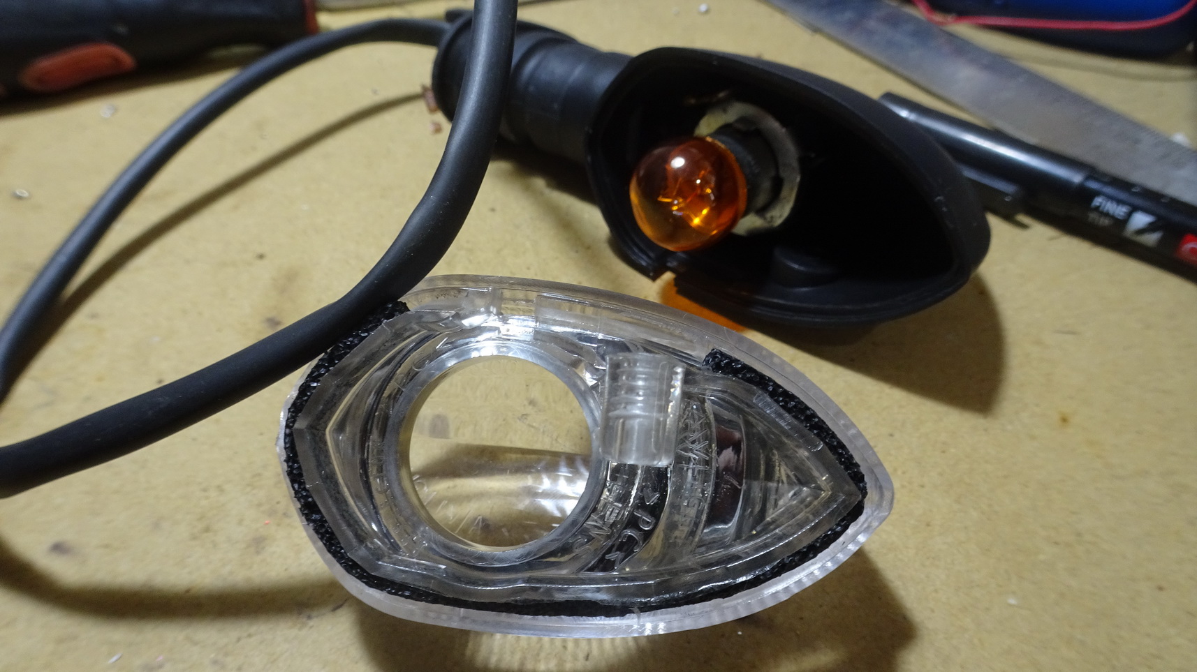

Breakin'em'up
Held with single screw. Easily opens up.
The lens.
Putting a screw driver in the small notch helps split the lens and reflector. Needs to be gentle, can easily break the glass.

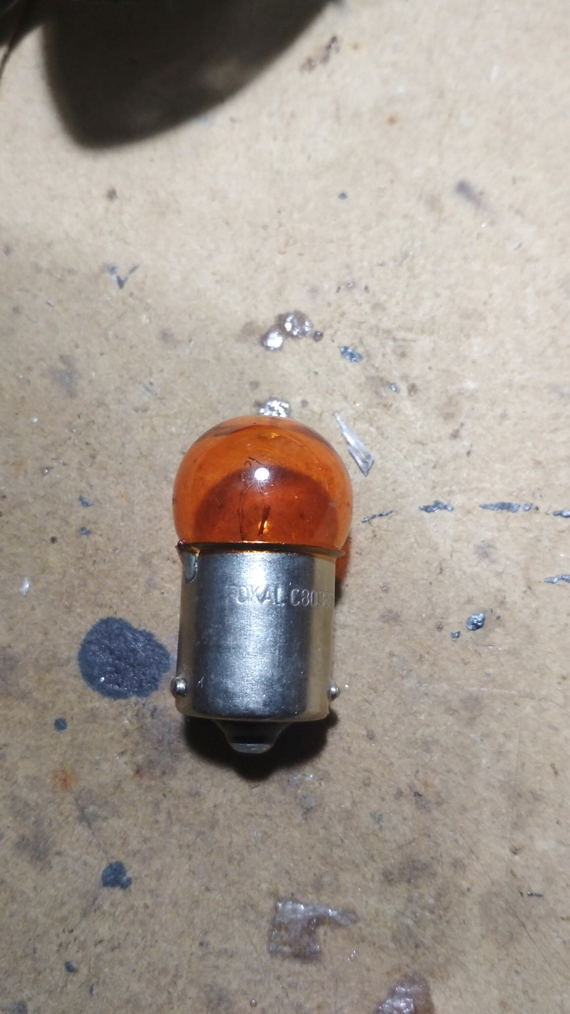

Bulb is no longer Phillips.
