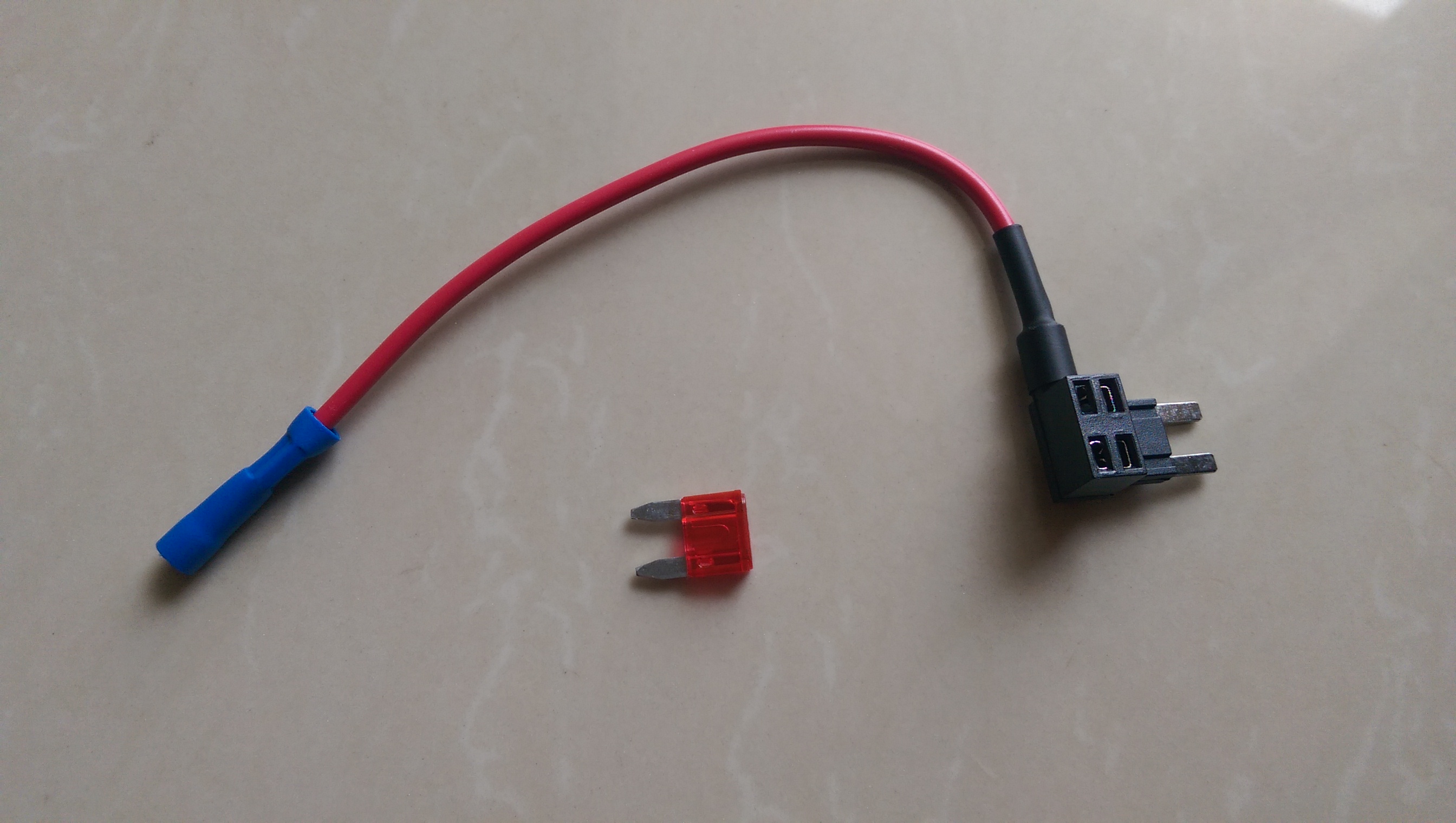

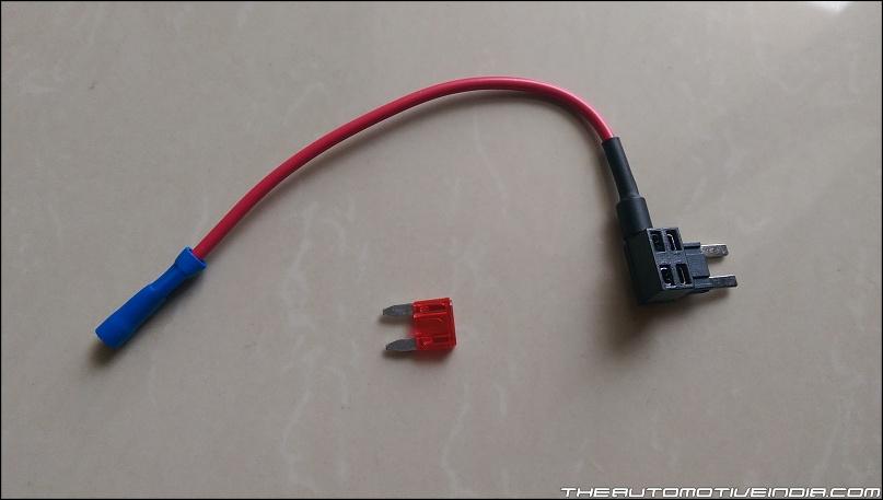

Mini ATM Fuse Tap. The blue pin is cut off and the wire will be soldered to dashcam adapter:
Power adapter 12V to 5V. The ring on the +ve wire will be cut off and soldered to fuse tap:

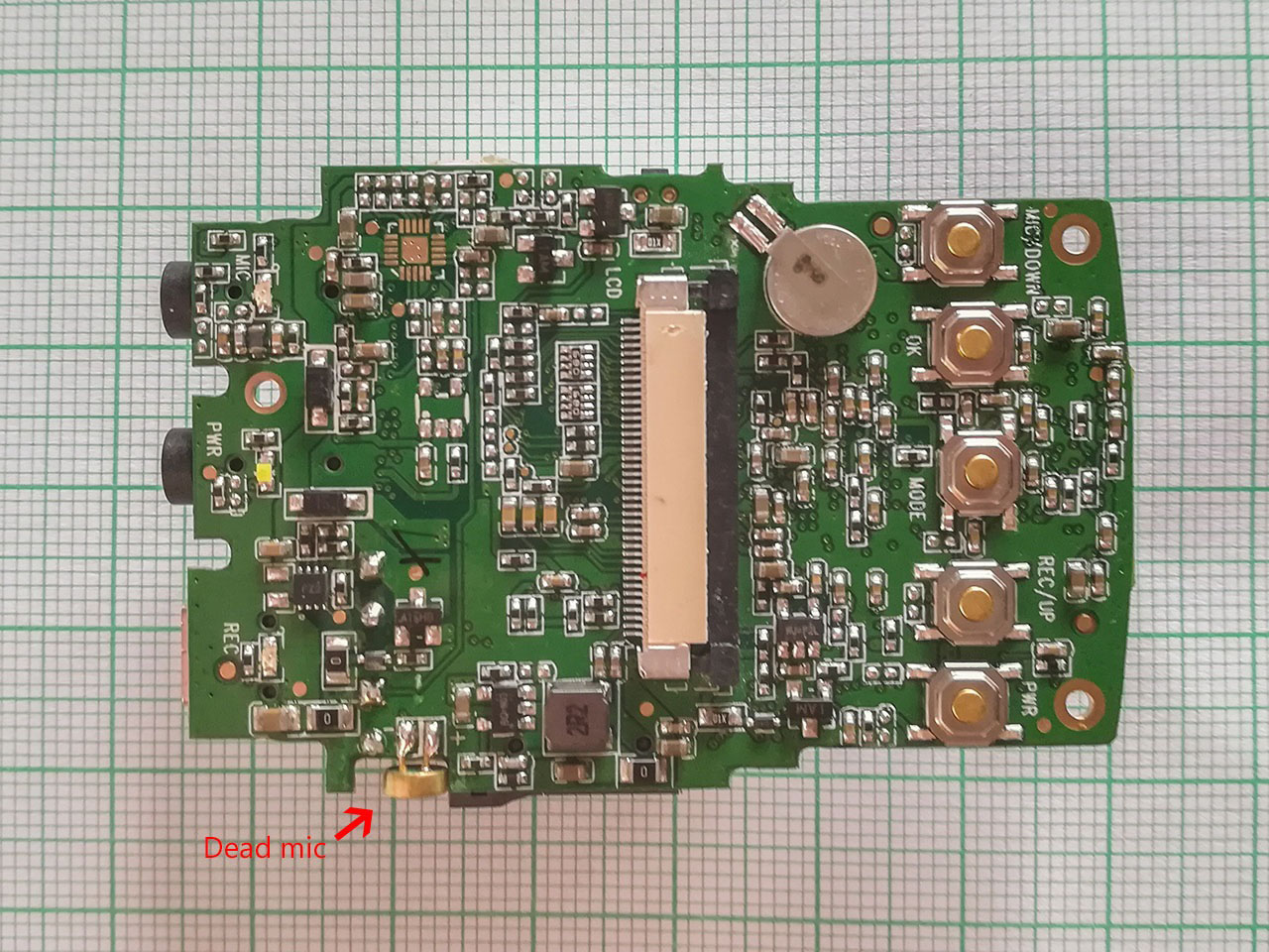

My replacement dashcam had mic recording issue and I was waiting for warranty to expire so I could open the device and fix the issue. Last week I disassembled it and replaced the mic but forgot to discharge capacitor before soldering and I burnt a MOSFET (A1sHB) which is used for switching from power to battery (capacitor). Fortunately that MOSFET is available online for very cheap and my dashcam is fixed now. [:D]
I have taken few snapshots of the PCB and attaching the same here.
Thanks...

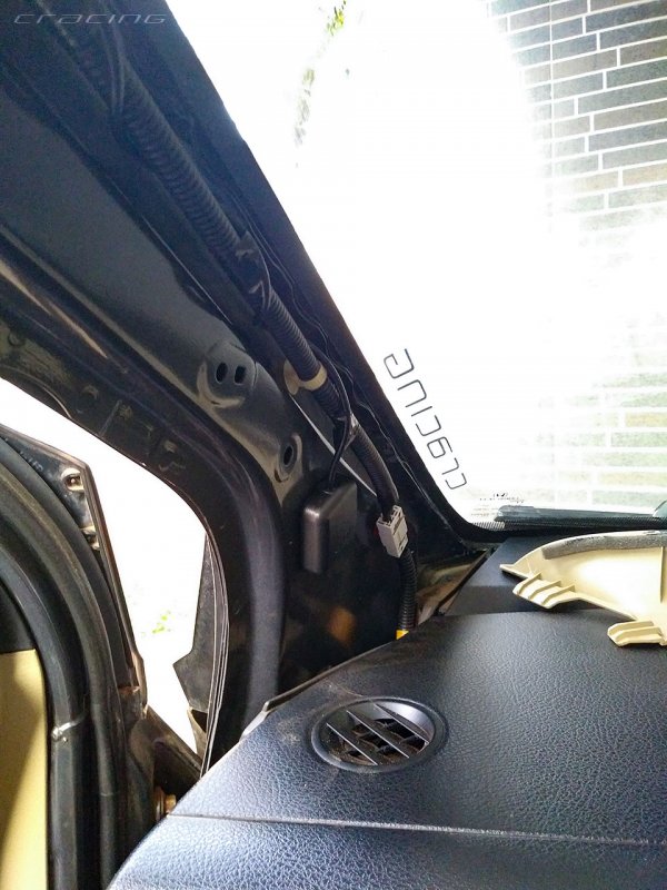

My best friend Prabhagar had bought a GPS module for his A118c dashcam but unfortunately, it didn't work. He tried his best to make it work but the dashcam was not able write GPS data into the video file. Since I have similar dashcam, he donated the module to me and I'm thankful to him. Surprising it is working on my dashcam and GPS fix is also rather quick. Here are some snapshots:
I have affixed the GPS module inside the A pillar and there is no issues with GPS reception. A pillar panel fits fine too. Wire is routed next to existing cables and through roof lining till dashcam.
The 3.5 jack is 90 degree bent so its a not proper fit for my dashcam but soon I will find a solution.
