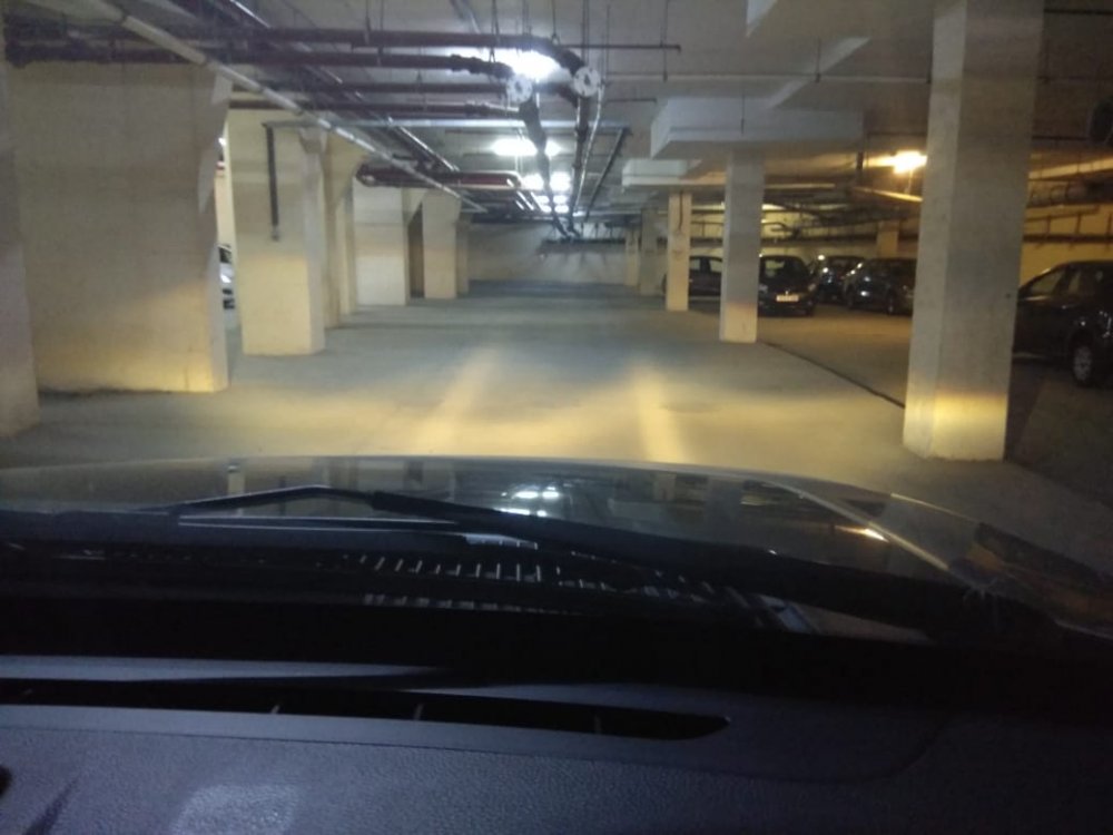

This is Seriously messed up. Check for-
1. Bulb is proper seated? Reverse bulb installed?
2. Projector alignment is faulty or has fallen from its mounts.
What do you mean by reverse bulb instal? There is a notch in which the h7 fits into. So I doubt reverse installation is the issue.
After fitting there is not vibrations or shake observed in the throw which indicates that bulb is properly seated.
Will check the alignment of projector...

If this is an HID bulb, it will have a return wire. That wire is on bottom for my Xuv. Check that. Otherwise it will cast a funny shadow like yours.
