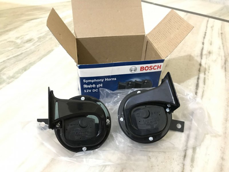

Got Bosch Horns for Amazon.in for Rs. 630/- Product Link here.
Some Pics of the actual product,

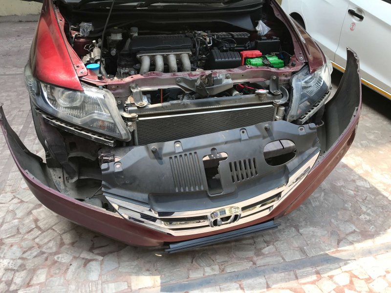

As its dual horn setup to install Horns Bumper needs to remove which is straight not that complicated IMO. High Tone Horn is located at the Passenger side and Low tone horn in the middle of car which can be seen easily.
Removal Of Bumper

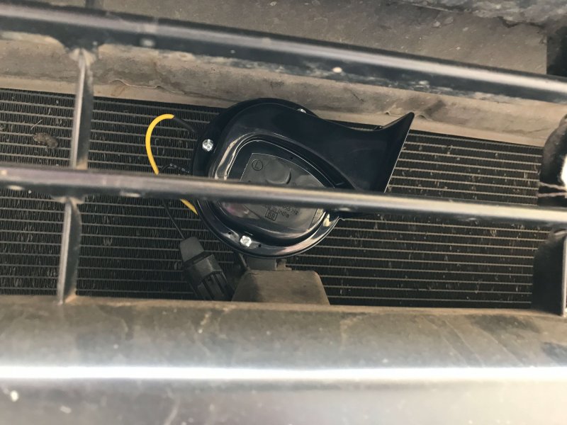

Passenger Side Horn
My earlier plan was to install center horn at the driver side so that it will get protection from water and dust. Same was done by Cracing but couldn't mange to find holes and position for horn. Will figure out that sometime later, as of now I have installed both the horns on the original position of the car.
Cracing Setup L And R

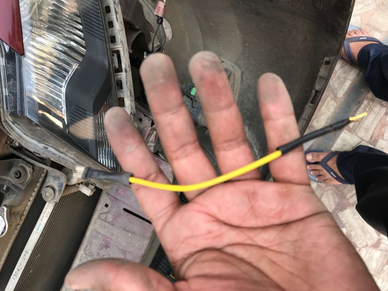

To connect Bosch horns with the car wiring used connectors and for earthing made connectors which is pretty simple. As stock horns comes with single connector and other aftermarket ones with dual connector, you need to connect other connector with earthing which is done by homemade connectors.
Homemade Connector Used for Earthing
Connector for Stock Wiring
How to Earth Horns
On the Car
