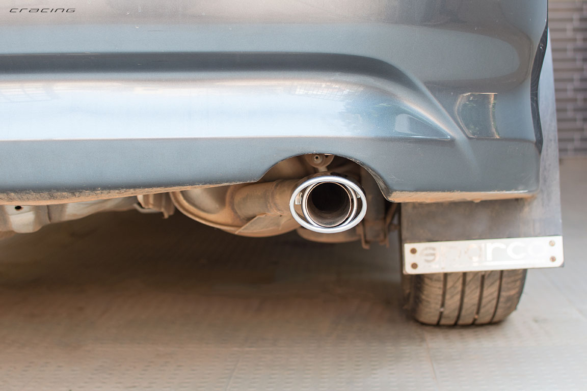

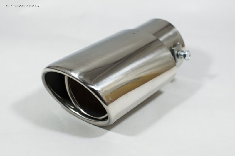

Seller shipped the product promptly and I received it today in well packed manner. I expected it to be different then shown in picture and low quality but to my surprise, its exactly same and thickness of steal is same as OE muffler tip. Well finished and feels solid. I think its Chromed steel but neither OE muffler tip looks S.S. There is chance of rusting so Dr Mudhan has suggested to electroplate to make it durable.
I took some snapshots from my DSLR and went to install the tip. Since this is universal muffler tip, it took more time to correctly align to muffler pipe. It wasn't 100% perfect or exact fit but not bad either. Actually the muffler tailpipe end is ~50 mm but its crunched inside (43 mm) and also curved (Diagram picture below). I had to fasten the muffler tip bolt to inner pipe and its firm now so lets see how long it serves.

Product Name: AutoSun Car Exhaust Tube in Tube Silencer Muffler Tip For Universal Cars
Product Link: Here
Cost: Rs. 345/-
Sold by: 24X7 SHOPPING ONLINE on Amazon India
Supported tailpipe dia: Min 35mm, Max 52 mm

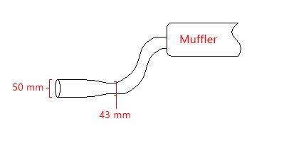

I have taken few more snapshots today. As you can see, the muffler pipe is little leftwards and there is slight gap in the right. I tried many times to align but still endup with gap. I think its happening because the pipe is curved inside or tip fasteners aren't designed properly. Anyway, it doesn't cause issues nor its noticeable so I will ignore it. [:)]

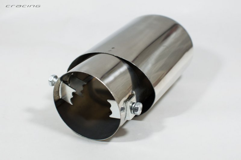

2. How tight do we have to screw the tip? Is it enough to ensure by testing with bare hands or should it have specific tightening torque level if any?
Tightening the screws until the tip is secured is enough. Clips/champs aren't strong and they will bend if over-tightened. I don't like the design to secure the tip, made on these Chinese Muffler tips. Some have faced issues like tip becoming lose or turning around after sometime. OE tip is much better, even though it has single bolt. Check the rear picture of both tips.

I see that the muffler tip has got three bolts so it should fit securely then mine. As of dents and improper finishing, send some snapshots to seller and he may refund you some money.
