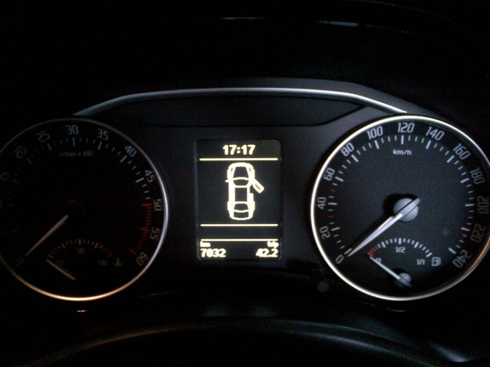

It started with me regretting the fact that i hadn't gone for the Lnk trim. Multifunction steering wheel, maxidot, tyre pressure monitoring system, front parking sensors, xenons, electric memory seats, extra airbags, two more speakers, touch screen music system, hydraulic brakes etc etc. Biggest mistake of my life not spending that extra 1.5lakhs. What was i thinking?? So the research began. Started going through briskoda, vw forums, indian forums and found out that many of these features could actually be retrofitted. I was skeptical though to say the least. With skoda's notoriously poor reputation in the A.S.S dept i knew the risk wasn't worth taking. I decided i wouldn't do anything that would void my 4 year skoda shield warranty. Just when i was losing hope, god gave me a little wink and i found someone within skoda who was confident enough to help me with these mods as long as i could assure him that the products were all oem. And there began my journey in converting my plain jane elegance to a bling king Lnk. I do believe a picture is worth a thousand words so ill let the pictures do the talking.
MULTIFUNCTION STEERING WHEEL WITH PADDLES
SKODA BOLERO RADIO WITH OEM SKODA/VW 9W7 BLUETOOTH KIT
MAXIDOT HIGHLINE INSTRUMENT CLUSTER AND CRUISE CONTROL
TYRE PRESSURE MONITORING SYSTEM , AUTO LIGHTS AND FRONT PARKING SENSORS
Apart from these mods i got a few accessories such as the chrome exhaust tips and a spoiler lip from skoda. All these together have completely transformed the car. I would not have been able to do this if not for some timely advice and help from my friends within and outside of skoda . I would be writing pages after pages if i were to describe each mod but i would be happy to answer any questions. I've helped a few people with similar mods and would be happy to help you.
