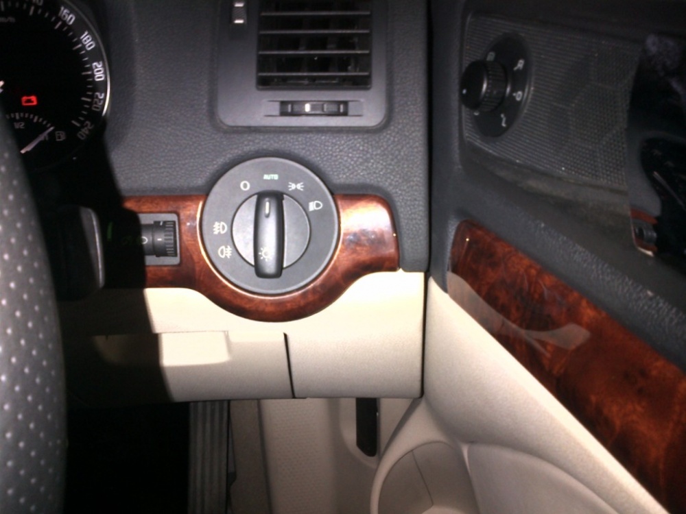

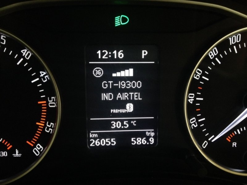

A few more mods..
Added the 9wZ bluetooth module which enables sms reading in the maxidot.
Also added the chrome auto switch. Just cuz it looks good.
