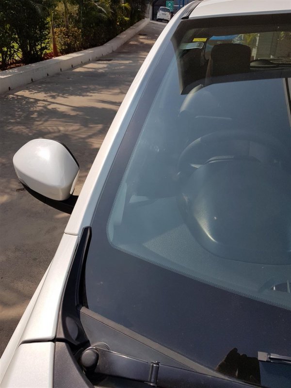

  1. Minor paint defect on right A pillar below windshield.
  2. 'Tick tick' sound from front both windows when glass is half open.
  3. Sound from the both rear doors when car hit potholes.
  4. Air filter body is of old design which rattles.
The paint defect was identified by my 6 months back and shown to TASC during 2nd service, they advised me in friendly manner that its not major and can be done later or before warranty ends. I was ok with that. When giving car for 3rd service I contacted warranty Manger and he immediately accepted and got the approval from Tata for this job under warranty.

So on monday I gave my car to TASC and discussed all the problems I mentioned above. They told me it will take around 3-4 days to complete jobs as removing windshield and refitting it is time consuming work. Also paint drying and windshield cement drying will take some time. I agreed.
Finally on Thursday I called CRM and he told me car ready. I went to TASC and checked what all work they did. I was really surprised to know that they replaced all 4 door's windows winder and air filter body too. The senior technician told me 'sir now you will not have any problem, we have changed everything'. I checked the paint work done on A pillar and fixing of windshield, I was really happy to see the quality of work. Took test drive and now not a single item was giving 'jhankar beats' (read sound). The car was cleaned properly.

Attaching pictures of re-painted A pillar and new Air filter body.
