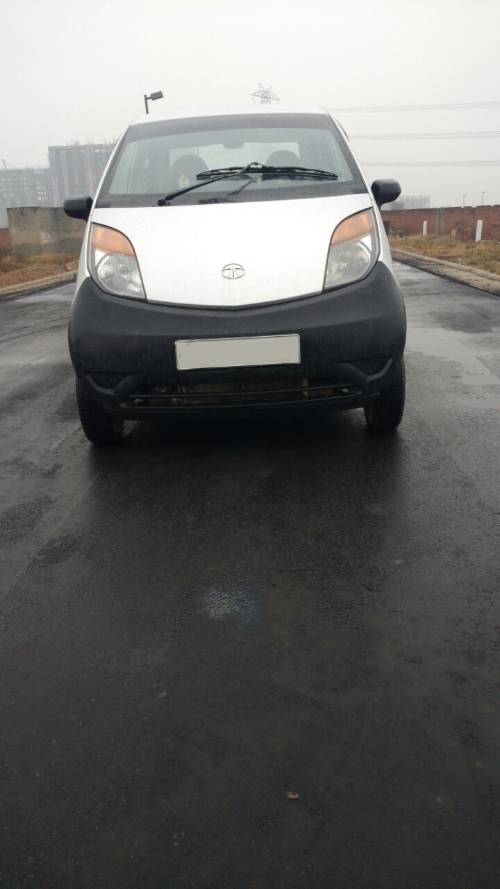

Update
some pics of changed hose pipe & my little champ after covering 12k kms
