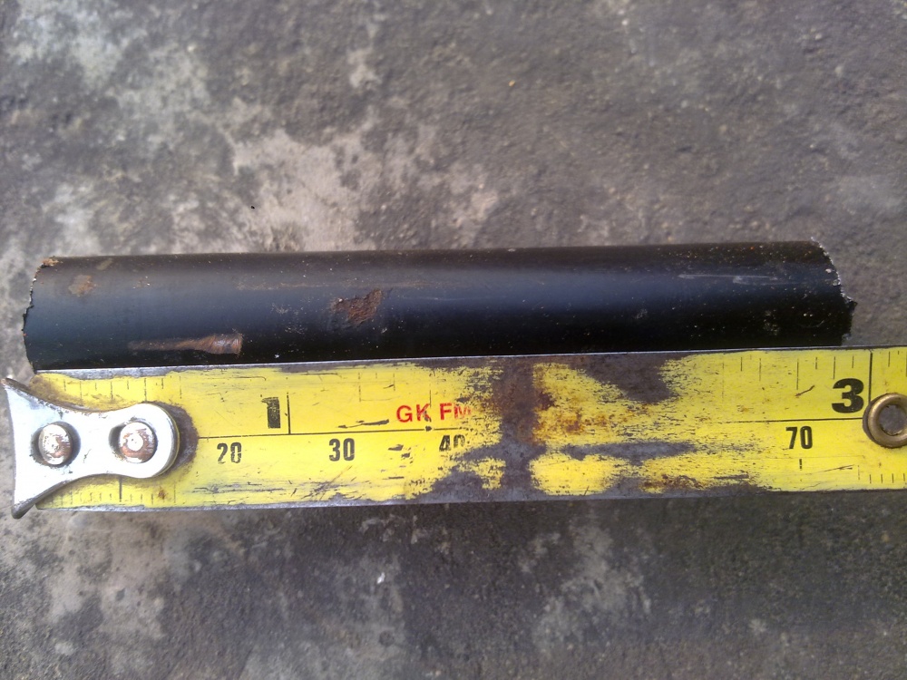

I have cutted the gear lever of my 800. its totaly DIY accept the welding process. Now it looks & Feel great. i maked it 3 inches small than orignal. in my friends car we make it 4 inches short. Now I'm looking for a gear knob and also thinking to change the center console.

as for the gear lever i always wanted to do it because when in 5th gear my 800's gear knob always rubbed with my legs so it was kind of an irritation.
but all of the workshops advised me not to do it. they said that if you sell the car it may be difficult for the new owner to change the gear. so i never did it.

Great DIY, Me too have cut the gear rod in my maruti 800..

I know everyone told me. but i ignore the all. first day its little quite difficult to put 2nd gear, i went to mechanic (my friend, he has already did it on his 800) he adjusted the gear rod under the body(which i had opened to take the leaver out) now it works perfect. its my habbit i dont listen to the mechanics & tell them just do what i say. i dont care about warranty & other things i know i can opreate. i do what i decided.

Just cutting the shifter will only make the lever harder to operate. I compensated by using a indegenious short shifter design, in which i cut off three inches from top, and added one which at the bottom,and raised the whole shifter mechanism by a inch. The whole thing was wlded and fixed. The gear shifter is now elevated, and the throws are really short. Will cut off another inch from the lever. The Altos centre console fits with some mods and the gear boot looks great.
