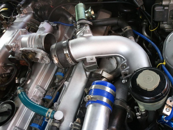

Hi Guys
My car had this problem of idling.
What was wrong :
- Engine not smooth enough
- Aircon will shut the engine down
- throttle not responsive
- Long Startup
How I fixed ?
Cleaned MAF
Cleaned TPS
Cleaned AFM
Replaced Pod Filter
Injector cleaner added
Throttle body cleaned with Carb cleaner
Stuff I used:
- Pod Filter
- Carb Cleaner
- Injector cleaner
What was wrong :
- Long Startup
How I fixed ?
Cleaned MAF
Cleaned TPS
Cleaned AFM
Replaced Pod Filter
Stuff I used:
- Pod Filter
- Carb Cleaner
- Injector cleaner
