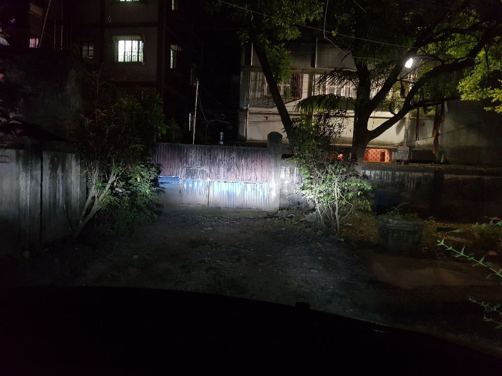

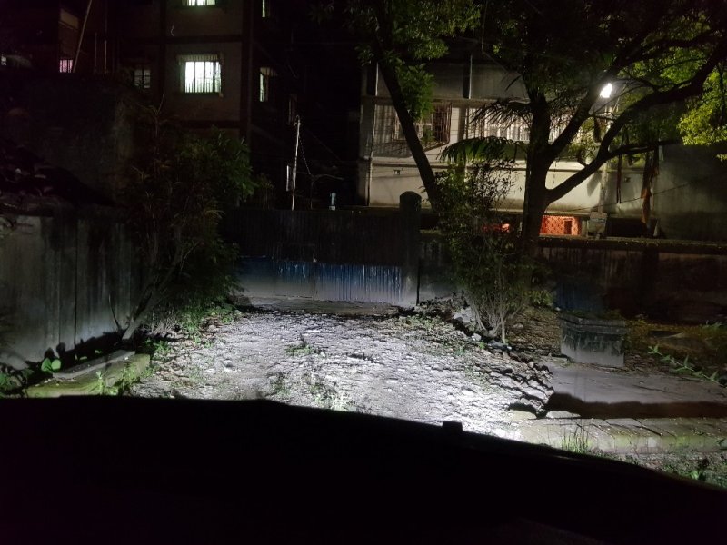

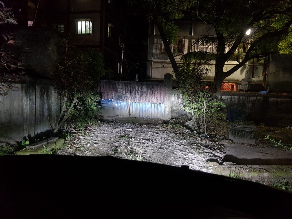

I have installed led in the foglamps too. Here are the photos.
1. Low beam
2. High beam
3. Only foglamp
4. Fog with lowbeam
5. Fog with High beam
Please note that the light is not as bright as it appears in the photo. The distance from the car and the gate is about 25 feet.

your beam pattern is not all that bad. however it is slightly narrow. high beam pic has absolutely zero foreground illumination.I suggest try aiming lights a little lower For better foreground.
low beams with fogs looks the best.
other reason could be 6000k color which is not ideal for eyes.
