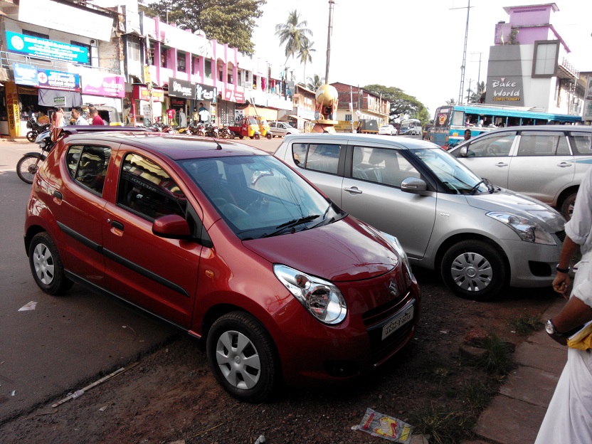

Here you see the almost 6 year old A-star with my cousin brother's newly brought swift(Delivery was just 30minutes before).

That 6 year old A-star looks new and glossy compare to that swift.No offense to the swift owner.
Here is my Almost 2 year old swift with 20k km in ODO
