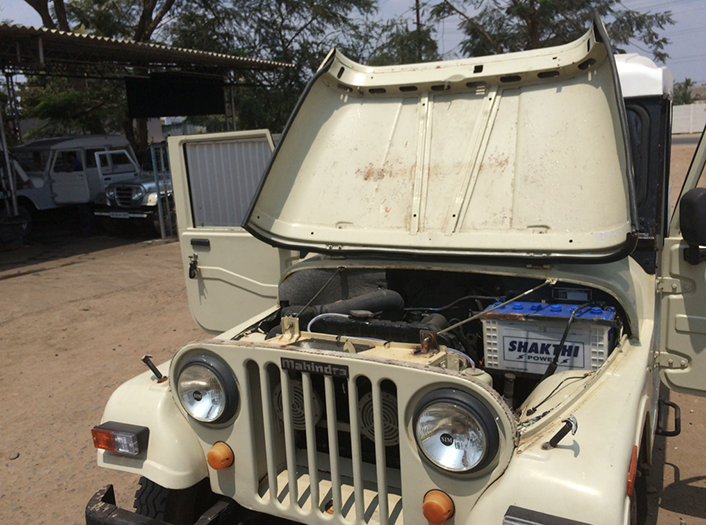

Sam and maximus as you said started finding surprises when they removed the sheet [lol] sharing few pics taken at the workshop!! before modif starts!!! [embarass]

Well well one of them is really nasty! very well we could and should except something like this in a govt auctioned vehicle .
Any way best of luck in your mods and I will pray the expenses fall behind your estimate buddy.

Rajesh, thats a lots of rust.
Get the body sandblasted. That would ensure that the last remanats of rust are taken care of. Check the chassis too; I hope there is no rust/damage on the chassis. Driving a vehicle with a rusted/damaged chassis is an invitation to disaster. Tell them to take the body off the chassis and check everything. Replace all rusted nuts and bolts with stainless steel ones - that would go a long way in rust proofing the MM for a long time. Be there at the workshop when the vehicle is being repainted. Ask them what paint they are using. Go for a good DuPont 2K job. Most workshop wallahs would spray a couple of layers of cheap Chinese paint that would shine brightly for a few days and would start to peel off thereafter. Dont let them take you for a ride. As I can see the present paintjob on your MM is in very bad shape. Buy OEM parts wherever possible. Get all hoses and belts on the engine replaced with new ones. Change all fluids/oils/grease and filters.
Did you try out the 4H/4L yet? Is it working satisfactorily?

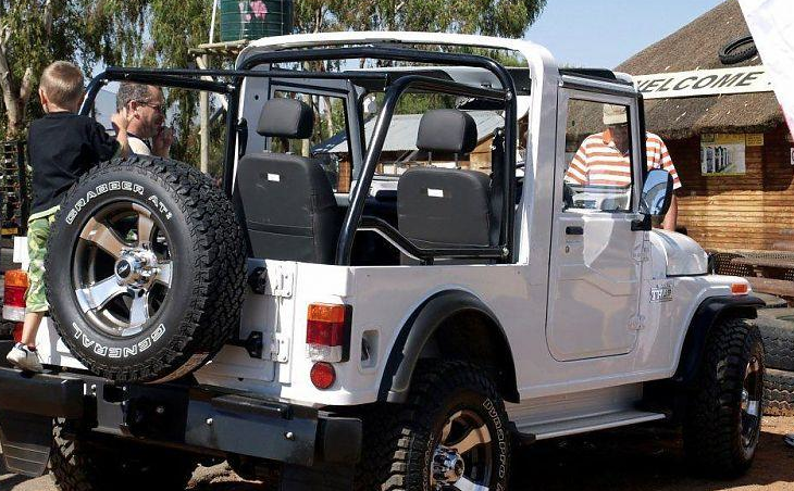

This is the Roll cage design i have finalised but with 2 inch pipes.
They have quoted 14K for this including soft top setup frames.

My suggestions:
Instead of keeping it open roof think of Hard Top, as cleaning it is always a troublesome task, if you don't get proper parking every time. My relative is having similar problem with vehicle.
Below is the link of Hard Top Video for Mahindra Thar, please see comments in Video for contact details,
https://www.youtube.com/watch?v=sBy7-SmkrQs
I would suggest a Ferrari red color if you are planning to repaint.

Really thanks amit for the video, I like red color but i'm really love with the elephant gray color.
Planning to add hard top to the front part alone. Do you have any idea how much it cost?.

I don't have any Idea regarding half Hard tops. My relative are planning to go Hyderabad for Hard top. The reason to go for hard top is during rains the floor start rusting from inside which permanently damages the floor. I have seen the hard top in Hyderabad personally, the material used and the quality of material is good and very neatly fitted.
The Elephant Gray or Graphite color shines for an year but starts looking dull. Where as the red would be much aggressive and sporty with black color badging.
I would suggest go for Ferrari red color with similar black wheel arcs as in "Thar".
